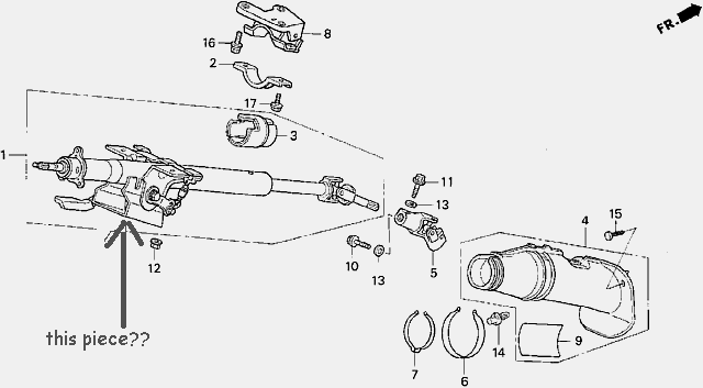

I will say, the plastic column surround also mounts to the "box", and even though had the wheel itself was dead on, the column surround was still slightly crooked despite my best efforts. I'd test fit the surround before you put the column back in so you can "adjust" those mounting tabs and get it right, cuz it's a lot tougher to do on your back under the dash. </TD></TR></TABLE>
This bracket that you speak of, can you be specific as to the location or better yet can you link me a picture as I want to get this fixed as soon as possible.

It's the piece welded to the column that has the mounting holes in it.

Default Re: (94CivicSi)
Old Sep 4, 2008 | 04:56 AM
94CivicSi's Avatar
Joined: Mar 2001
Posts: 1,654
From: Providence, RI, USA
that's the one.
