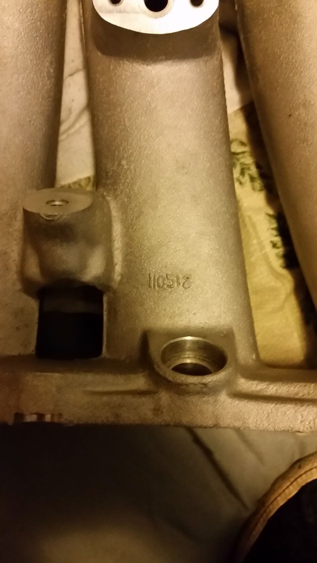

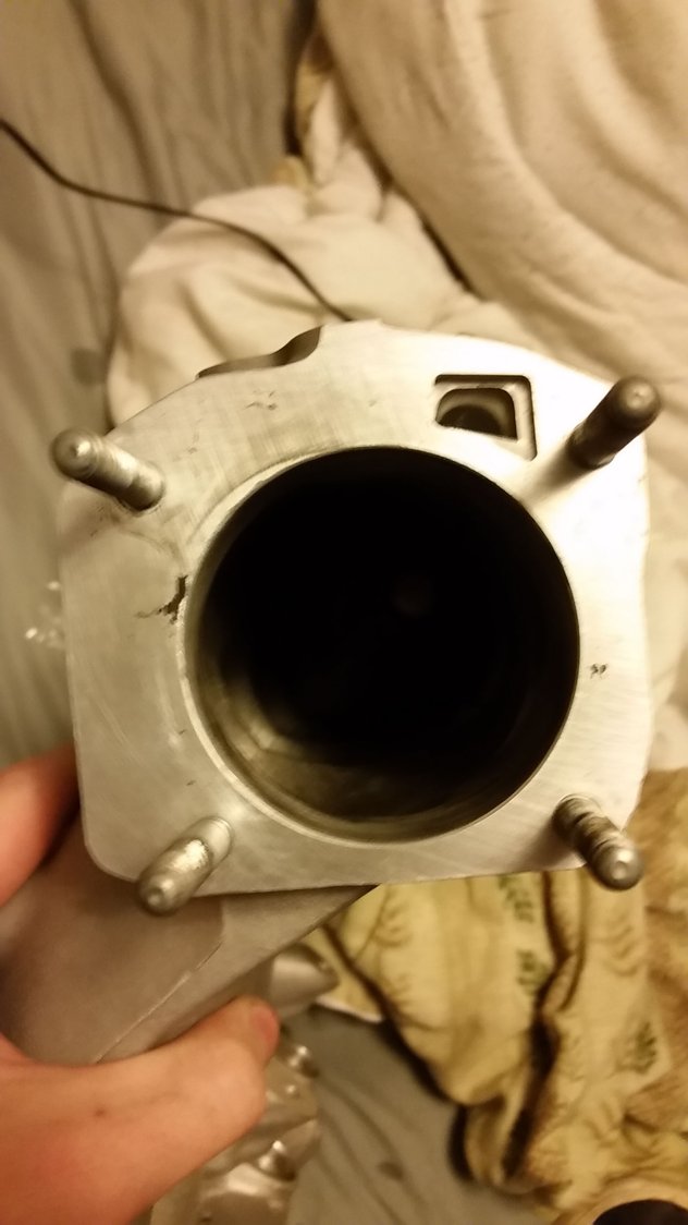

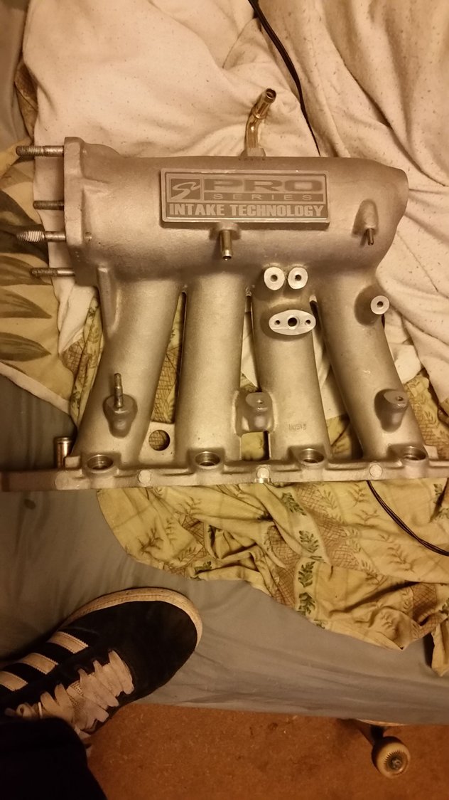

My friend got a skunk2 pro series intake manifold for free and doesn't know which motor it fits on. I couldn't find the normal 307-05-xxxx part number on it. But it has two other numbers on it that I tried looking up and couldn't find anything.
120421 on the top.
110518 on one of the runners.
Is there anything I could measure or something.
I'll try to put pics up.

It fits a LS or CRV engine (B18A/B or B20B/Z).

Thanks man. How do you tell?

Low center bolt hole on the top row combined with the super low water bypass port and the witness mark next to that where the EGR port would exit the intake manifold.
