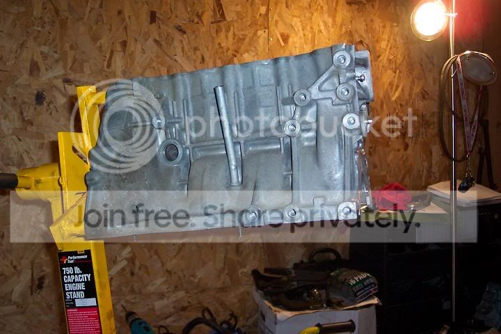

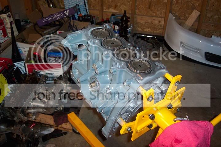

Old Sep 13, 2005 | 07:37 PM
EJ1 wilcox's Avatar
Posts: 5,735
From: Portland, Oregon
Default Re: Removing Aluminum Oxidation from Engine Block (TurboCoop)
Here are some pics of the block that I'm building right now...
Here's what it looked like when I got it back from the machine shop. The machined parts look awesome. The cylinders are money, but the outside of the block has oxidation on it.
I took some steel wool to it to clean it up a bit, then masked it off and painted it with high-temp, grey engine paint.
I also painted the valve cover and the intake arm the same color. I don't have any pics of the valve cover or intake though.
