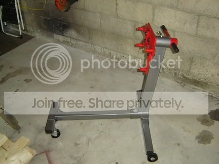

I went out about bought this today:

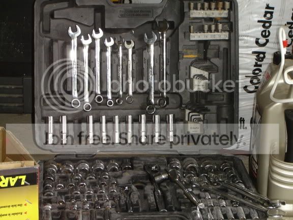

To help me along. As well as my few tools I have that have saved my *** more than once

The torque wrench is also a must have, despite what has been said in other threads. It takes an extra 10 seconds to set the tq wrench over a regular socket, and that's cheap insurance. Make sure it's a clicker or dial/digital gauge type, not a bending beam model, but you probably knew that. You might end up with 2, since there is a large variation in torques between some of the bolts, like I did.
You might want to pick up some additional sockets too. On the last couple of engines I rebuilt, I used my 3/8" drive metric deep well set about 95% of the time, but that other 5% I was really glad to have the extras. I have a small 1/2" set for crank pulleys and stuck bolts:
