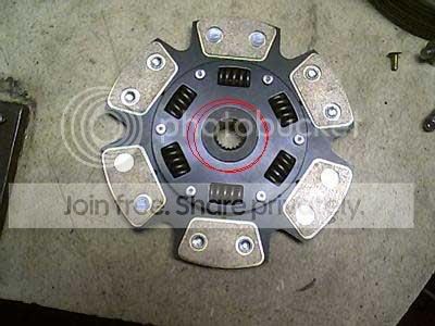

I removed my tranny because i somehow got a rock inside the case (running w/o flywheel cover) and got a hole in it . Anyways, I got a new tranny but as i am putting my clutch back in, i notice some play on the disc near the shaft. Wanted to know if this is normal or should i replace the disc. Disc is an Action 6 puck sprung.
Circled area is where the play is. Thanks in advance for any info.

That's not normal or good. Did you actually see the rock or just assume it was a rock. Are you sure there's not a piece broken fro that clutch. If the clutch is allowed to move around like that your bound to run into other issues. Like balance and the way the pressure plate mates to it. Replace that clutch.
