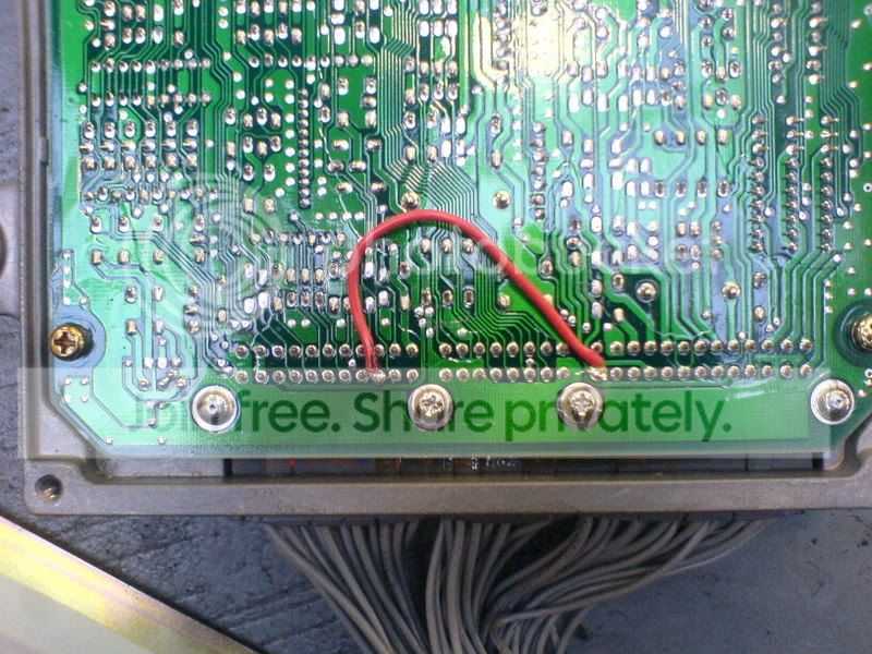

i just opened up my p28 ecu after having a mapping sesssion to find this
now can anyone tell me if this is a good or bad, ill let you in to what the tuner told me

That looks like someone wanted the VTEC pressure switch open all the time. They jumped A26 and D6 permanently grounding/opening the VTEC pressure switch.
Have you run that ECU in your car yet?
Modified by GhostAccord at 7:48 PM 2/25/2008

thanks for the reply ghostaccord,
will there be any long term effects keeping the VTEC pressure switch open full time?

Default Re: p28 inside- good or bad- opinions needed (civic j)
Honestly I have never seen this done before. It must be for some sort of hack or a piggy back VTEC controller. The ECU isn't supposed to see any voltage coming through from the pressure switch until after the parameters have been met for VTEC to engage and the VTEC solenoid has been opened. If it does see voltage before then it should throw a code 22.... Have you tried it in your car yet?
Some one else may have some more info on what kind of hack it is exactly. I don't see any use for it if you are going to be running a chipped ECU with a proper tune and an operational VTEC system.

Default Re: p28 inside- good or bad- opinions needed (GhostAccord)
yes, i have this chipped p28 in place of my original odb2b p2t ecu with a conversion harness in my ek civic,
what happened was, it was throwing a code22 (VTEC pressure switch) and this was his idea to erase code22 the result was to ground out what you see above,
i have tried it on my motor, but not for long, only becaude it was running pig rich returning poor gas mileage,
What engine are you currently running in your EK? D16Y7, D16Y8 or an H22A4 OBD1 or OBD2? I'm wondering why he didn't suggest to fix the code 22 vs doing this hack.

personally I'd pull that out of there. Not only for the fact that the solder joints and jumper look like crap, but simply grounding the VTEC oil pressure switch will eventually set CEL22.
the jumper should go from A4 to D6 to get rid of CEL22.
I'd do the jumper in the your conversion harness not in the ECU.

Default Re: (Relic1)
I asked what engine because I'm still wondering why he didn't just suggest to fix the VTEC Pressure switch.... Unless this is a non VTEC engine in that case just disable VTEC on the chip. Why even do a hack at all? Get rid of the jumper all together and fix the real problem.

i agree with him.hum?ive never seen that done before thats some hacked up sh**t there,and to be honest the solder job doesnt look all that good to start with.was the ecu chipped also?

im running a b16 VTEC motor, tuned on crome pro,
when it was at tune shop, cel22 was staying on and VTEC would not engage, and this was his way to get rid of the code, which imo does not look very good!
so how would i go about getting rid of the cel22, jumped from the harness a4+d6,

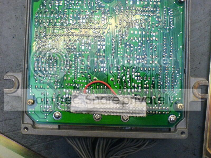

this is what i saw when i lifted the lid ??!?!!!!

dear F'ing god. Duct tape conducts electricity.
NEVER take your car back to that person. They obviously have no clue what they are doing.

cut that wire!if it was me i would just desolder it.cut it as clos the the board as u can with out cutting the board.
