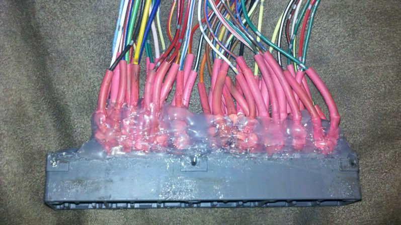

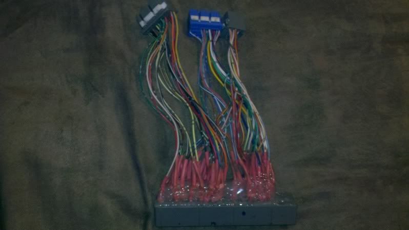

Made my jumper harness today thanks to the link ^above ^... It really wasn't that hard to do. It was taking too long to solder it so I just used un-insulated butt connectors. Then I used heat shrink to cover the butt connectors. Just to be on the safe side I went a little over board on the hot glue but, Nobody will see it so It doesn't bother me.. So, what do you think???

Looks a mess but looks like current will travel threw the insulators. Good job
