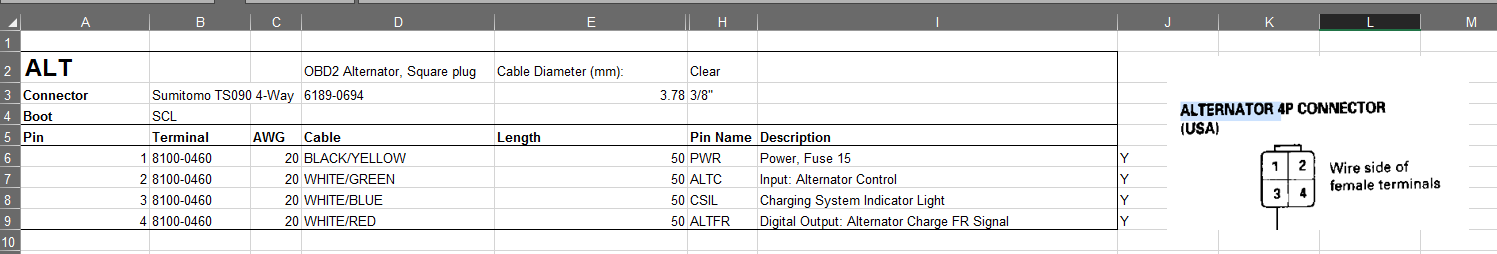

Hey guys, didnt post here in a while, need some help.
anyone have a pinout of a obd2 4 wire square alternator connector ,or mabey a picture of a oem connector, i couldnt find anything on the web every pinout out there is wack, i got a new connector and i need to crimp the oem wires to it,
thanks

Considering that OBD2 covers the last 23 years of vehicles,maybe you can be more specific.
Do you know more or less what year alternator you're talking about?

Default Re: obd2 4 wire square alternator connector
If you mean D/B Series engines, here you go:
THANKS ALOT!
