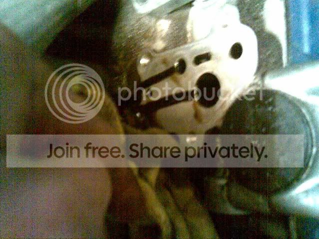

alright well i did what you all told me to do i tolk it apart, and the screen didnt look clogged so i cleaned it out any ways! now my car is still showing code21 and i cant get my rpm past 6000 it will hit six and if i hold the gas the rpm will drop! now i need some help i have some PICS!!!

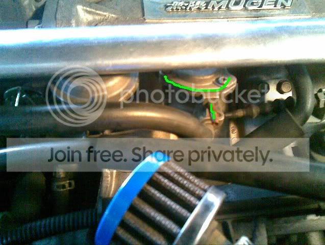

ok first off i need to know what the hell this is! its not connected to anything! and in a later pic ill show you some thing!

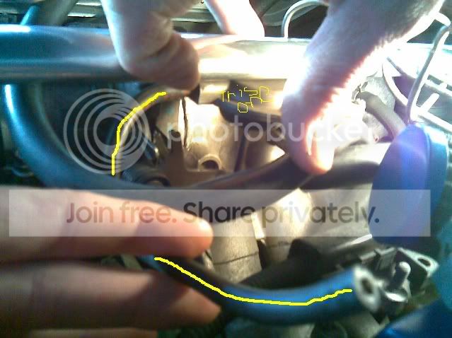

now this is where i think it should connect to but when it is connected my rpm will stay at a higher rpm like 3500 and sit there!

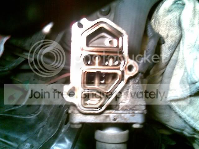

now here is a pick of where the vtec selonide conects to the head does it look ok?
and this is the ctec selonide! i dont have the gasket seal on it as my dad was cleaning it at the time!

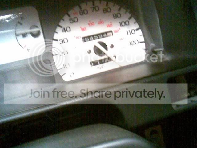

have you checked to see if the VSS (vehical speed sensor) is hooked up.? if the speedometer does not work vtec will not work.

how do i check if its hooked up do you have any pics? also my speedo needle is past the 220km mark on it and it stays there how would i go buy fixing that?

What I would do is grab the vtec solenoid off a friend's car and try it. I believe the D series ones will bolt up too. If that fixes it, you have a solution. If not, you wasted 20 minutes and a few drops of oil.
Now the thing on your intake manifold is what's called a throttle chaser. You don't need it. What it does, is when you let off the throttle, it's supposed to bump open the TB just a hair so it revs down smoother. If the link to the TB gets bent, it will make it idle higher. I wouldn't worry about hooking it up. Never have, never will unless it's already done.
Back to the vtec solenoid. I would run a continuity test from the solenoid to the ecu wiring. That will tell you if there is a break in the line. If so, run a new line or track down the break and fix it. If it's good, it's most likely the solenoid or low oil pressure.

alright thanks, but now i need to find some one with vtec selonide that i can borrow? but some one previosally said that if my spedo is not working then my vtec will not work! well in this pic shows you where my spedo is at.. it doesnt move it just stayes there..

if you speedo isnt working, check your VSS (vehicle speed sensor on the back of the trans) if this isnt solved, you def wont get VTEC to work...
