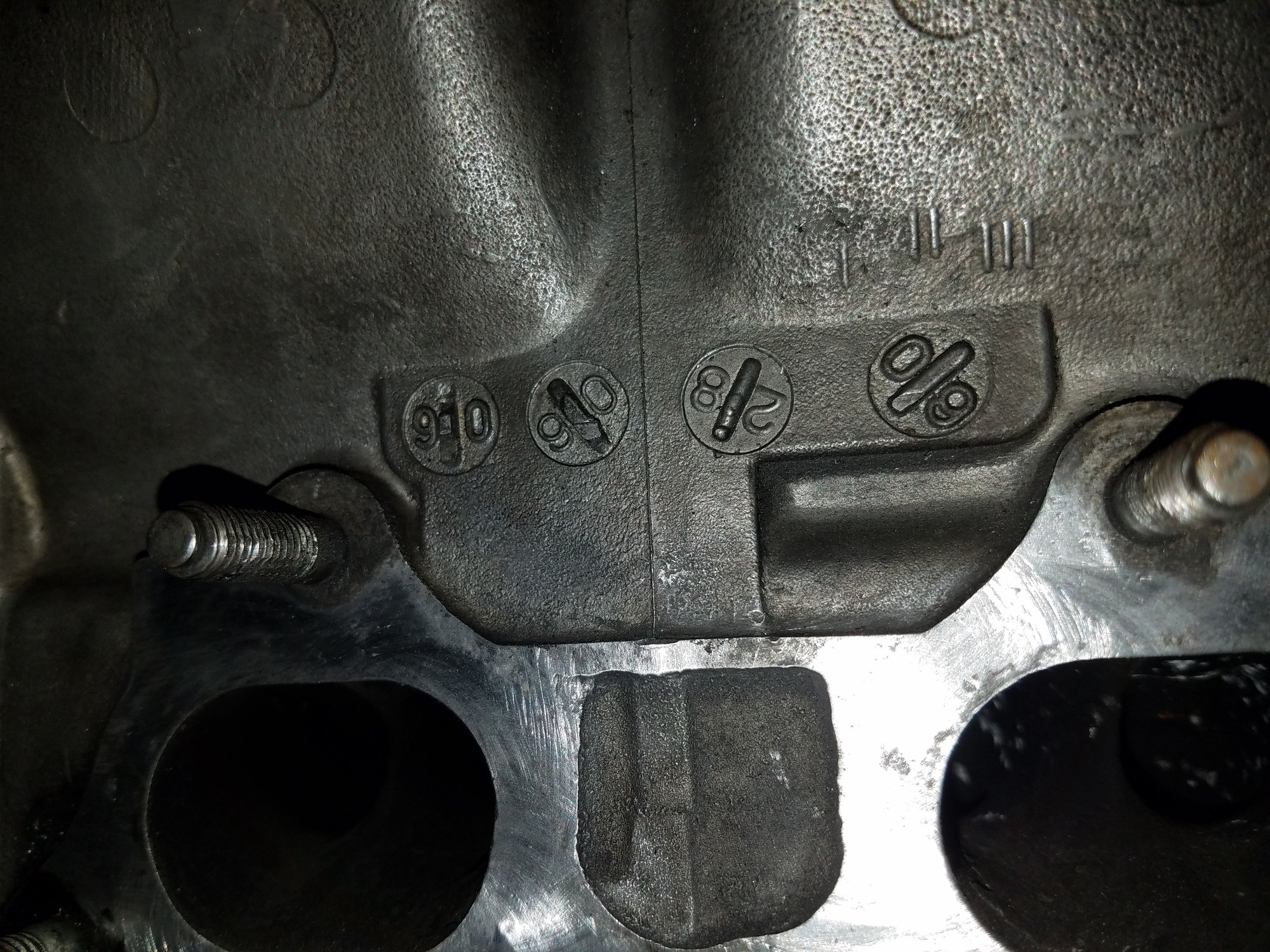

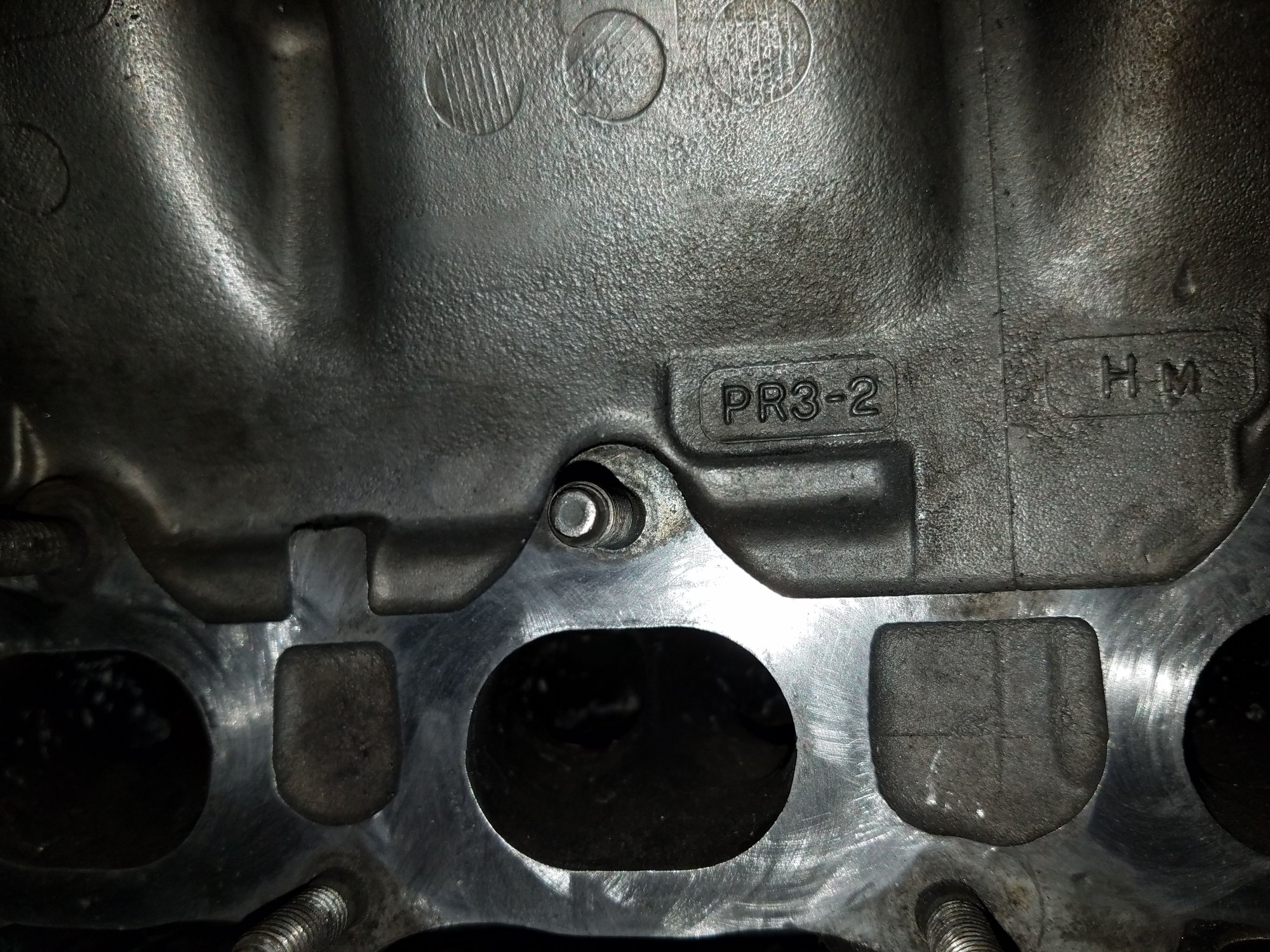

hello everyone, thanx for checking out my thread....anyways i received a head from a friend but its completely bare ...Ive been doing alot of research but it still is unknown, can someone plea
se help me with some real answers....i uploaded a few pics of the stampings.....and if you were going to build this head ....looking at it like money was no issue....how would you go about it and exactly what parts would you use...keep in mind running a b20 planning to go frankinstien all motor or as some people say frankinstien na. thanks for everyones input...good or bad ide like to hear it all....tia

A simple google search for "Honda PR3-2" gave me the following thread that says exactly what head you have.
https://honda-tech.com/forums/tech-m...-specs-748421/

Date stamp tells it all... manufacture date of 06/90 means it is a JDM 1st generation B16A cylinder head found in a 90 Civic/CRX SiR or '90 Integra XSi
