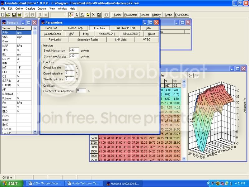

i've check the whole lot, tho. spark plug was mint!! does it even say anything in the software if you can adjust thecold start up fuel adjustment?

heres a pic of romeditor 4 for s100-s200
