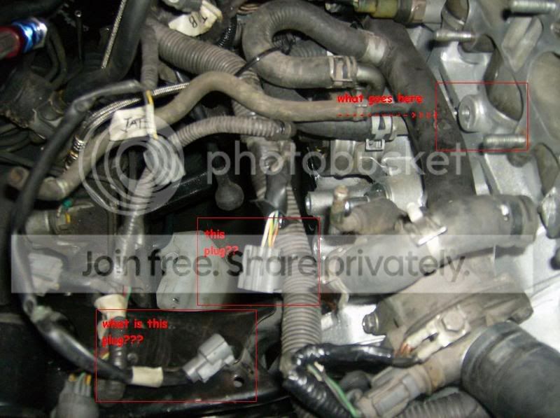

ok so i swapped over to a victor x intake manifold and i have a couple plugs that im not sure where they go....this is on a 94 integra GSR btw...thanks guys!!
--lower left, the long plug...is this the purge solenoid plug? i think it is...colors are green and red..
--the 4 wire plug...wtf is that? colors on it are white w/red, yellow w/black, orage w/black, green.
--the threads on the head...i thought this was for coolant temp, but i have that on the t-stat housing...i dont remember taking anything out of here, but apparently i did cause the coolant tube has marks on it.....wtf goes there???

anyone know of a good thread that lays out what plug is what on a gsr wire harness? or is it layed out in a manual somewhere? maybe wire colors or something? any help would be appreciated....

4 wire = 02 sensor.
Wat you have labeled as IAT is purge, and the green/red is the IAT.

THANK YOU, THANK YOU, THANK YOU
Ef8kid got all my questions answered via pm's what a life saver!!
got my plugs straight, and im plugging the mystery hole lol
