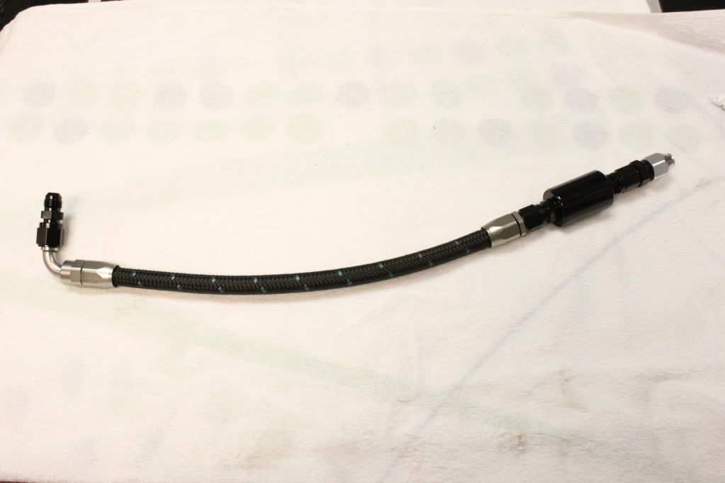

Hey guy's, I am getting ready to start my direct port nitrous setup but want to do a few things first to clean up the engin bay a little bit
I would like to get rid of the fuel filter that is mounted on the fire wall and do an inline fuel filter, I assume since it is just rubber line going to the fuel filter from the pump I could just use a aeromotive or jeg's or one of the hundreds of other inline fuel filters and mount it underneath the car in a safe place right??
Also right now I have a fuel pressure gauge that the previous owner mounted on top of the fuel filter that I would like to keep, Can I just move the gauge closer to the rail with something like a T fitting right at the fuel rail OR should I tap the rail??

Can someone just let me know if my thinking is correct with just doing an inline fuel filter along with the associated steel braided line and A/N fittings??

Yes you can use an inline filter.
Yes, get a fitting for the fuel rail and install the FPG on the rail.
Where a sending unit, [or FPG] is mounted depends on what FP you want to read, fuel pump pressure, or fuel rail pressure, [before or after FPR] . 94
