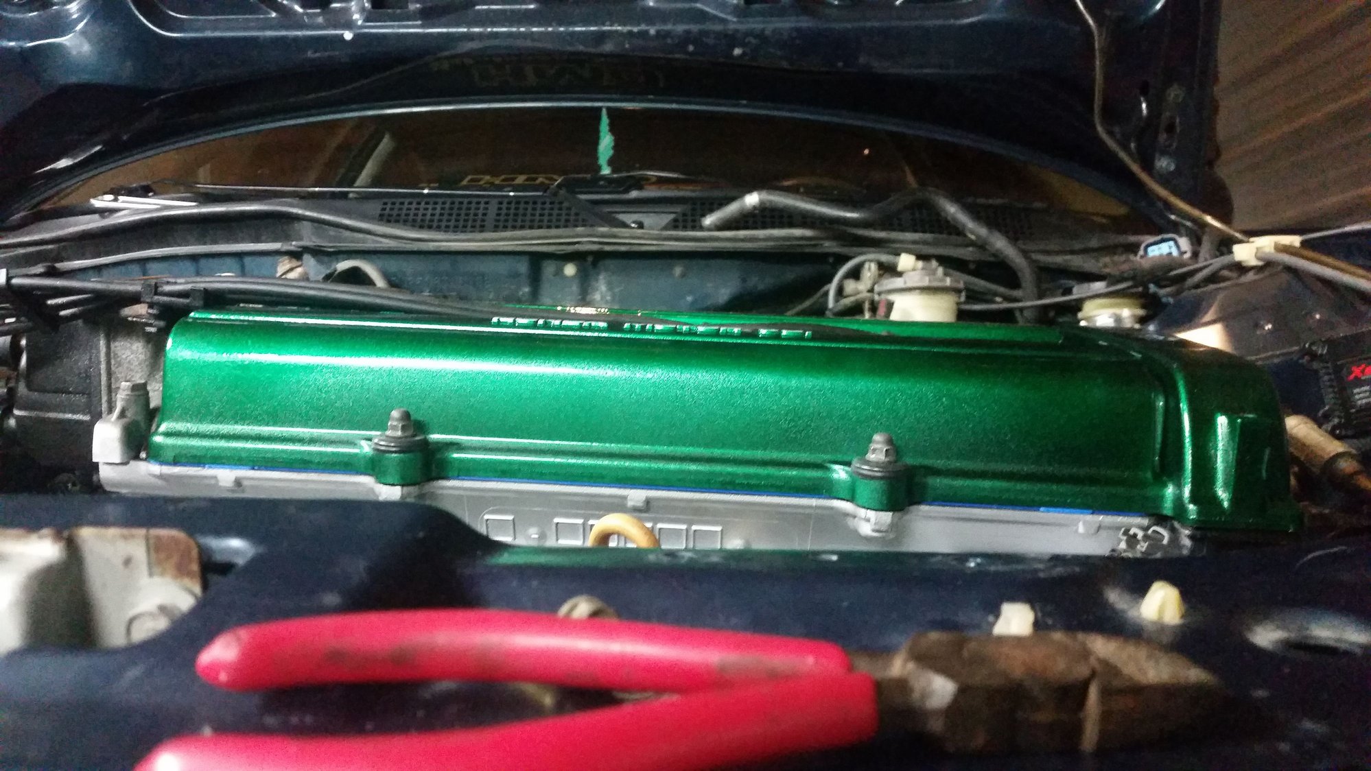

Hey guys I have a 1996 honda civic had d series put a b20 in the motor sits lower on the driver side have the right rear t bracket and mounts can't figure out why it sits funny thanks guys

Sits higher on passenger side

You must exchange the drivers' side engine bracket with one from a '99-00 Civic Si. Then it will sit at proper height.

Thanks!
