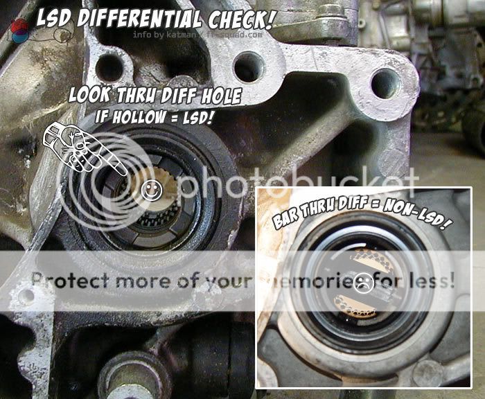

kinda of a noob question. when i do a burnout it leaves stripes from both wheels. does that mean i have an lsd?? sorry dont know much about trannys or lsd's. any help would be appreciated

two marks does NOT mean LSD unless your tripping.
Just means lack of traction on BOTH wheels.

A more easier way, jack up the front end and put them on jack stand. Rotate one wheel and see if the other rotate in the same direction, if it rotates in the opposite direction then you don't have LSD. And check for any "LSD" stamped on the tranny case to see if there is an OEM LSD installed.

your theory is flawed

1 wheel in grass
1 wheel on concrete
which wheel spins?
