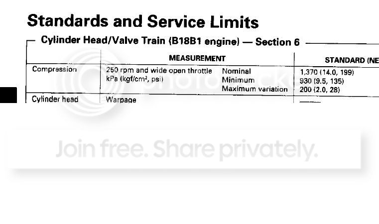

Old Mar 19, 2010 | 06:19 AM
lsboost3d3g's Avatar
Joined: Feb 2010
Posts: 145
From: miami
Default Re: ls motor compression test results

Originally Posted by mouab18c1
Its more of what range it should be, not exactly what number to expect.
its still a spec. 199 psi nominal. i don't go by specs for things like that, but i'm just saying there is an actual spec for it.
