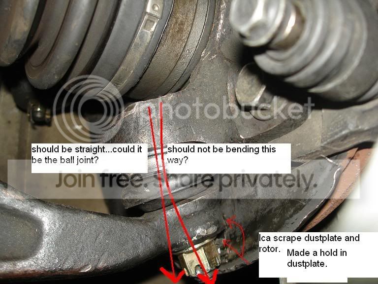

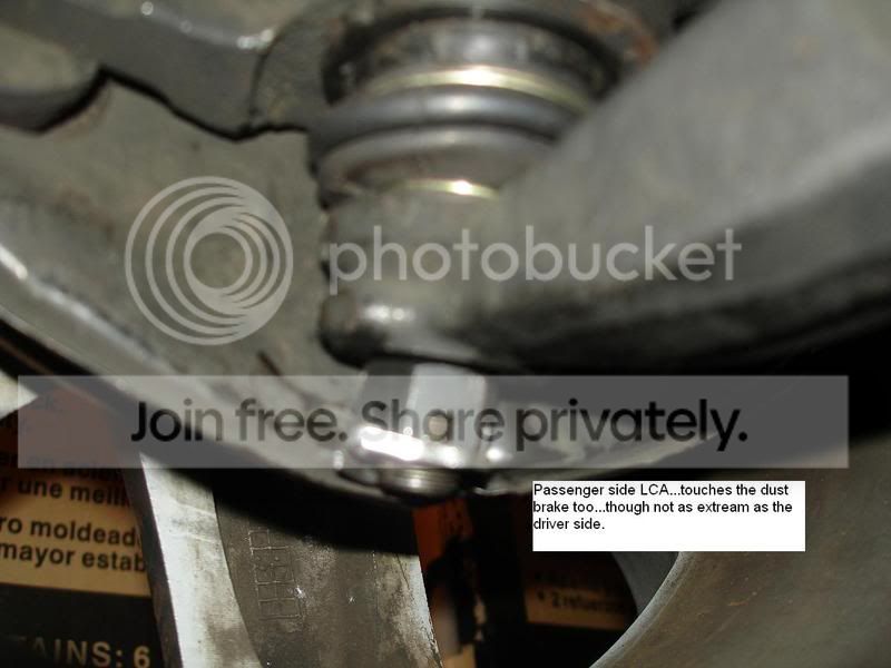

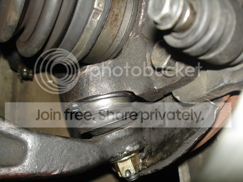

I just got my car up and running, but noticed that everytime I drive it...it makes a grinding/scraping of metal noise. Thought it was my wheel bearings, but after having a look underneath the car, I found out its my LCA.
What I did to the car before noise:
I had my driver and passenger side lower ball joints replaced, since the boots were torn...got them at Autozone. I took the hubs off and had a shop press them out and in. And also did an alignment and my rotors resurfaced. I didn't replace the brake pads, cause they were still good.
After installing everything and driving it, I hear this noise. So I want to know if anybody has encounter this problem and what they did to solve it. Thanks.

did the dust shield get pushed back into the lca?
Old Jul 14, 2008 | 08:36 PM
methos713's Avatar
Posts: 2,410
From: Sacramento, CA, USA
Default Re: LCA scraping dustshield and rotor... (jdm inc)
no, the front lca is pushing into the dustshield. Without the dustshield, the lca would be pushing into the brake disc.

That ball joint looks like it may be a bit too long is it after market or OEM? Or your camber angle is just a little bit off Did you drop it and if you did how far and did you use a camber kit?

I'll take another picture of the scrape mark on my lca.

its not the dust plate. I've been searching all day today and I think it might be because my lca's are bent. I'll take some pics of my lca without the car being jacked up when I get home.

Maybe the ball joint is too high. Compare the gap between the knuckle and LCA against a stock EG. It does appears that the gap is larger than normal. Check the wheel bearings while your at it... shake the wheel with the wheel off the ground and see if you have any play.

okay, I finally got to replacing my front lca....though I did say I was going to like 2 1/2 months ago. I know its been awhile, but I've just been busy with work and family stuff. Anyhow, after replacing the driver side FLCA, it still does the same thing.
So I guess nothing was wrong with the original flca. I don't know what to do now...could it be the lower ball joint....could it be because of my camber kit....or how the toe was adjusted during alignment...but then again it was making noises when I took it to have it adjusted.
Already spent $$$ on those brand new lca...which wasn't the problem...and now I'm don't know what else to do.
Help me out guys...I'm stump.

It does look like the lower ball joint is a little tall. I know you said its been like two months but I would cross reference some part numbers and make sure they gave you the right ones. Them boys at the zone have been known to pull the wrong part. Happened to me last weekend when I went to change my axle seal had the axle pulled out to find that the seal was to big.
