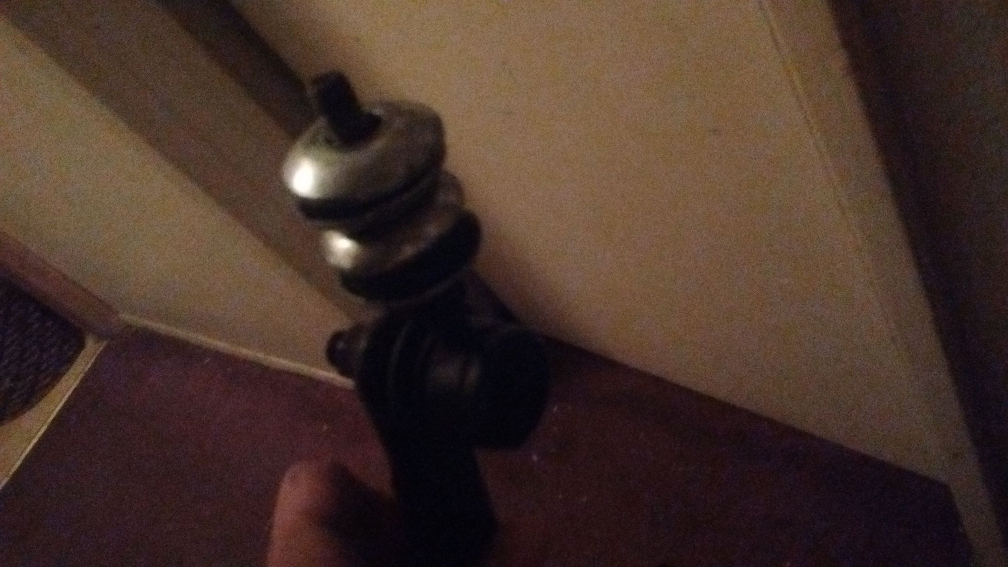

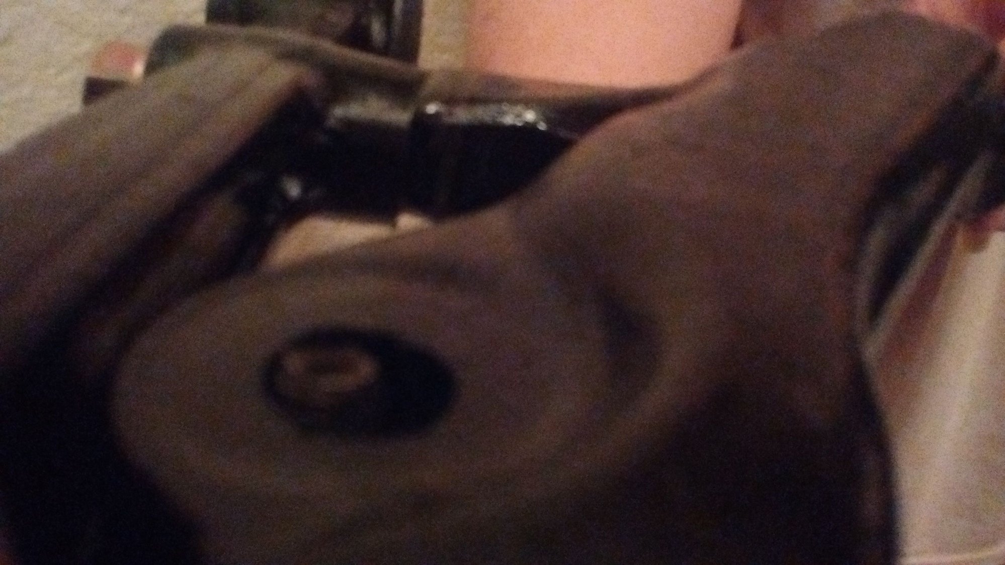

Do I need civic endlinks? Doesn't even fit thru the hole. EX/si arms

You can't use Civic endlinks, they wont fit the ITR swaybar. I'm not understanding your issue though, then endlinks you have should fit fine. The stud looks to be the right diameter and length. Better pics might help.
