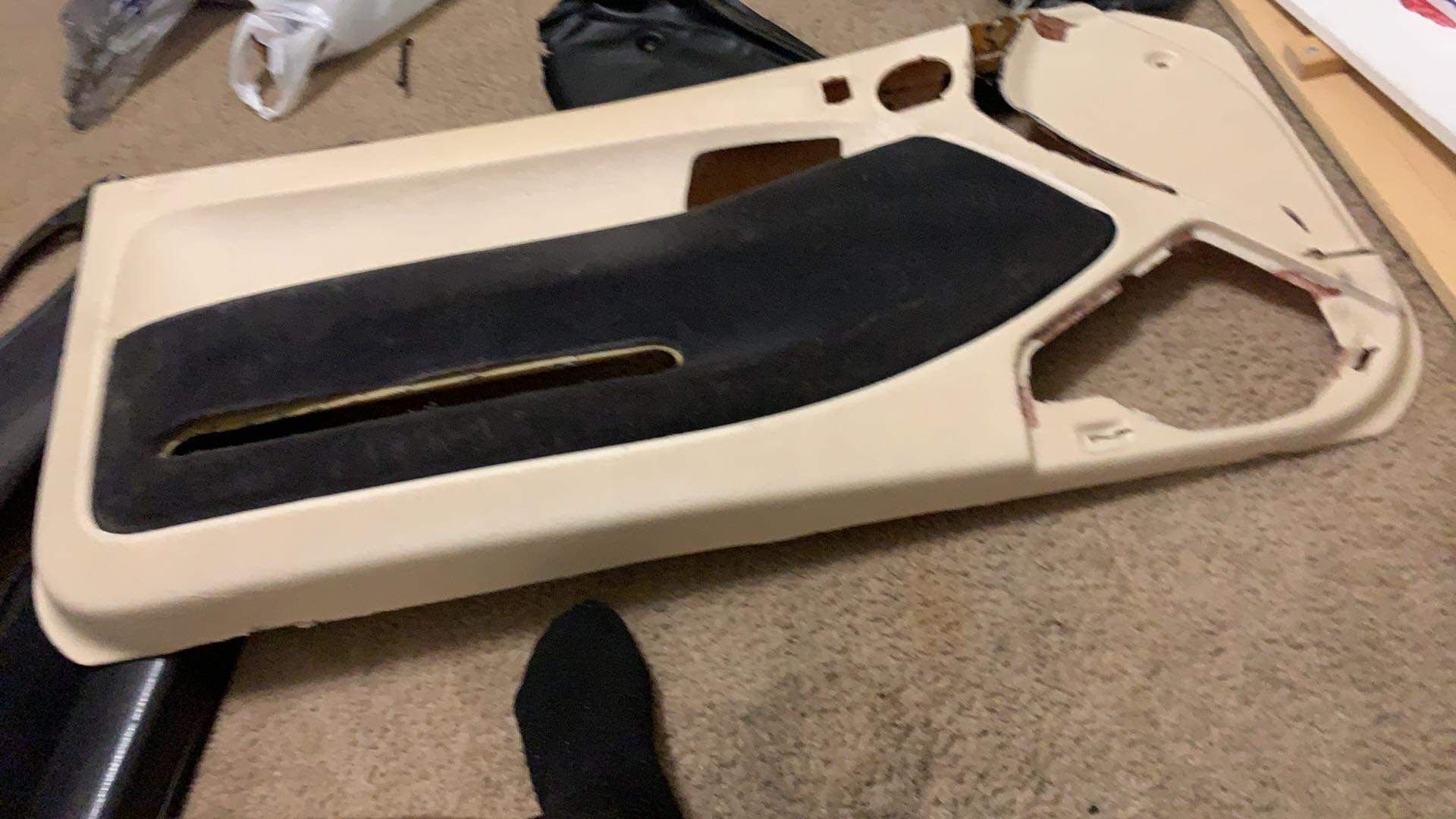

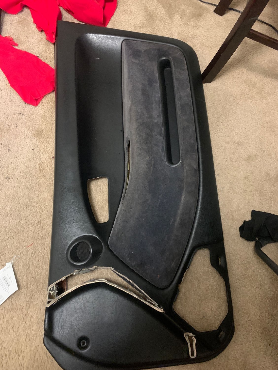

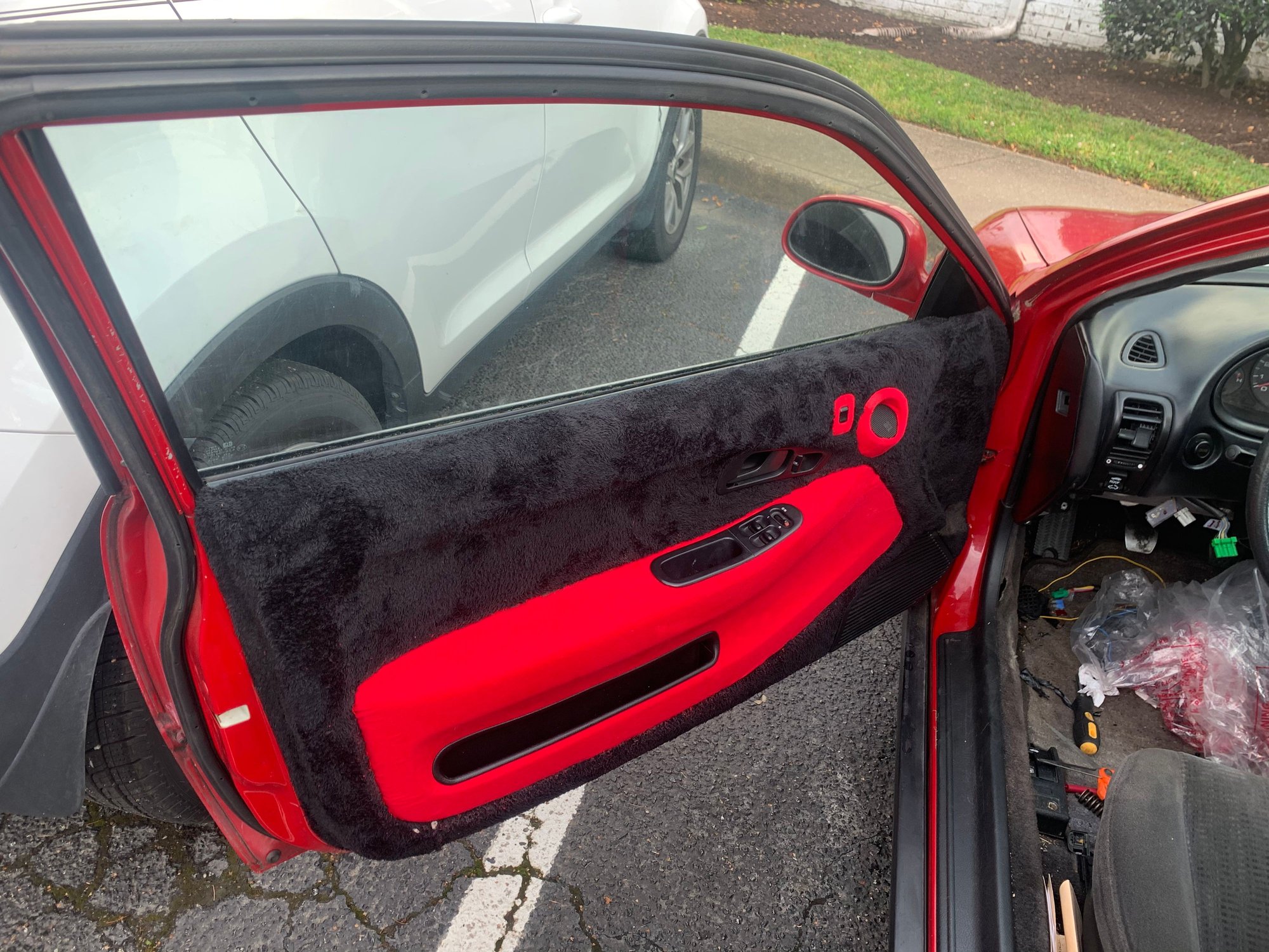

I did an Integra to eg swap thanks to @litterbox and everyone that comment on the post .
but those wondering about the door here how I did mine:
Take them off the door and cut them to where the doors close .
Rip the fabric on it out and buy whatever color of fabric you want to install on it from Joann or Walmart . And buy 3m Super 77 spray glue .
The result

Holy **** Carpet Batman...
Stylistically, is that making a comeback ? Did you fill the gaps in the door panel with something before covering it with the fabric ?

I didn’t left it as is due to door closing fine . Plus it’s not Rubbing so fabric won’t rip .
