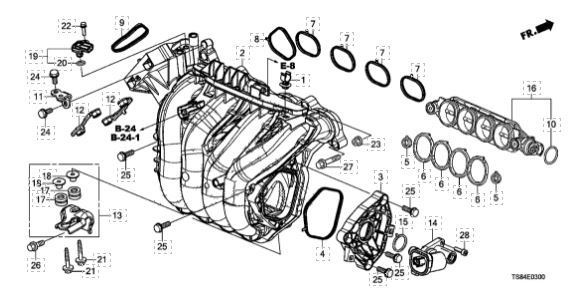

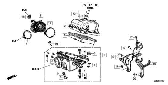

As for the IACV, I was under the impression that it was on the top of my throttle body while the FITV was below. But taking a look at these diagrams from Honda it looks like the MAP sensor is above the throttle body.
Do you know which (if any) of these is my IACV? Haven't been able to find many details on any diagrams.
