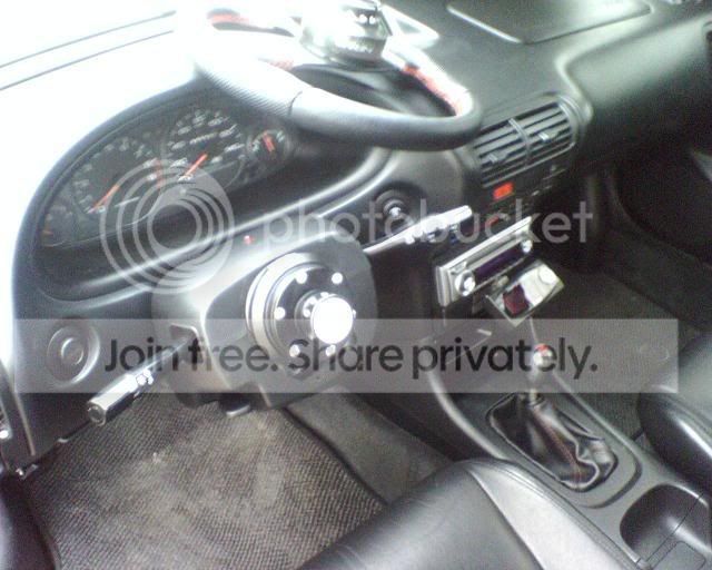

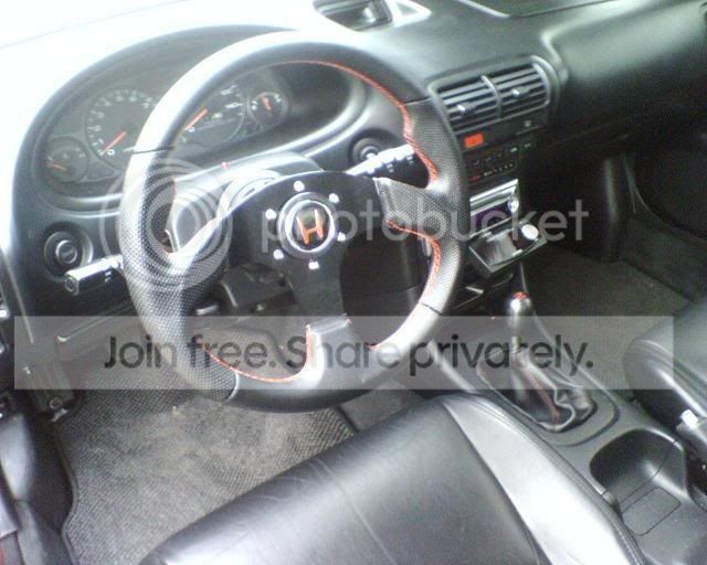

Old Sep 30, 2006 | 04:29 PM
vtecDadC2's Avatar
Posts: 455
From: Where the Hondas come out at nite, Ca, united states
Default Re: installing a quick release and hub....help (sErJo1 DohC2)
Old Oct 1, 2006 | 11:41 AM
TypeRider98's Avatar
Posts: 156
From: homebase610, Pa, United States
it gives your car a whole new feel. i never want to go back to a stock wheel again. if only someone could figure out how to make a jdm type r wheel detachable.
