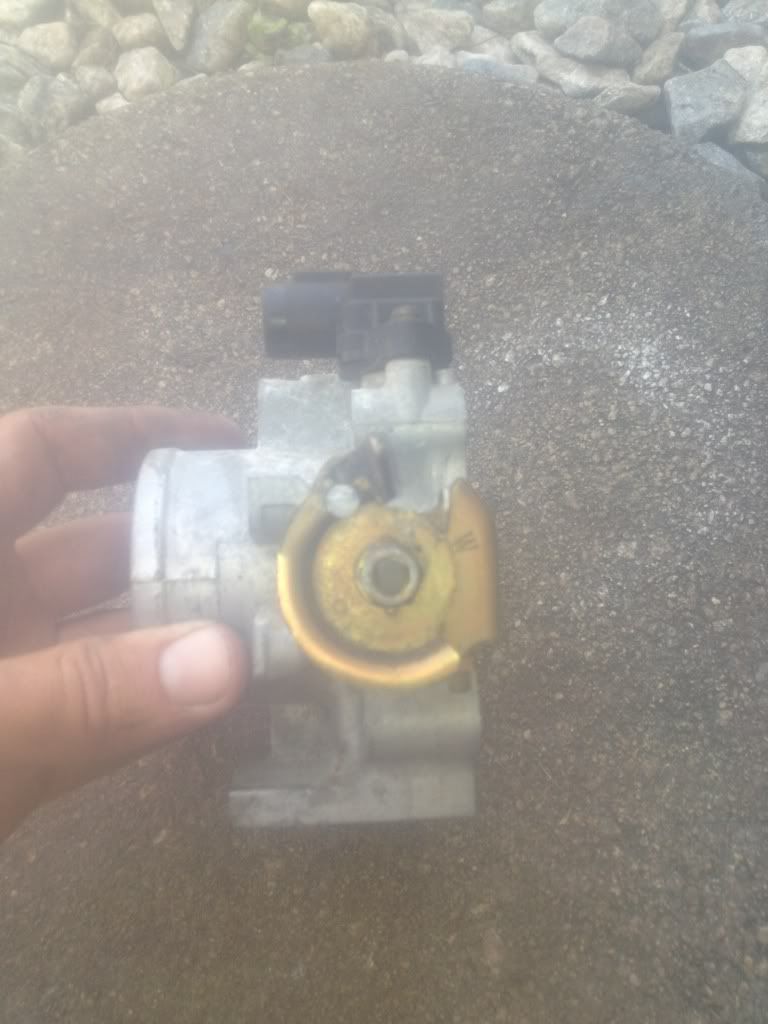

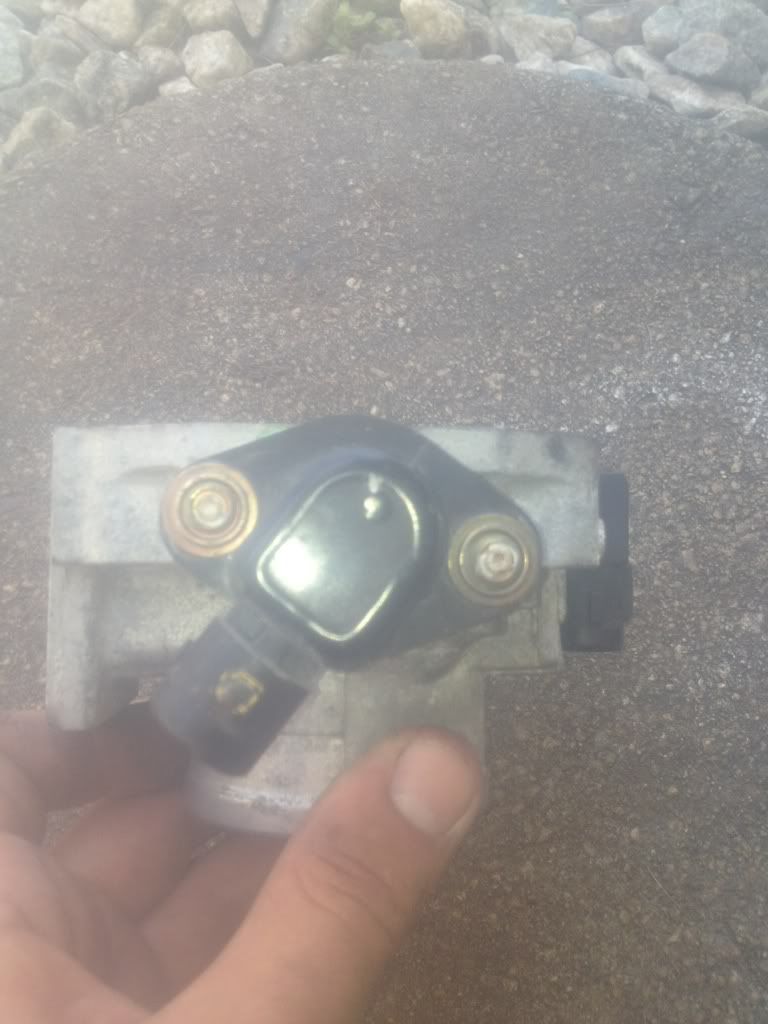

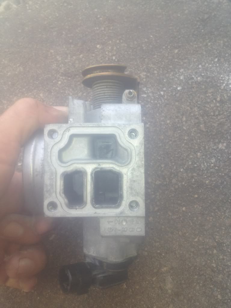

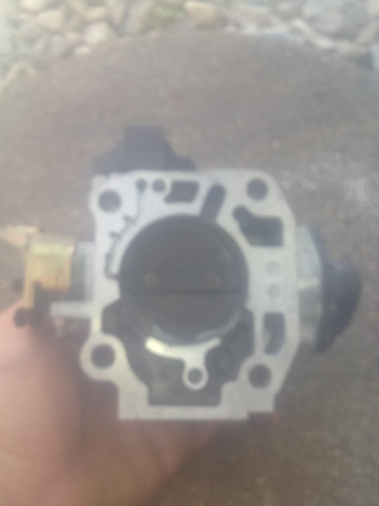

Identify this throttle body please
Old Apr 26, 2013 | 06:54 AM
miamihonda's Avatar
Joined: Apr 2012
Posts: 80
Default Identify this throttle body please
http://i1048.photobucket.com/albums/...psed0848b3.jpg
http://i1048.photobucket.com/albums/...ps721a2e58.jpg
http://i1048.photobucket.com/albums/...ps26db567a.jpg
http://i1048.photobucket.com/albums/...ps41707190.jpg
http://i1048.photobucket.com/albums/...ps1a964972.jpg
http://i1048.photobucket.com/albums/...psb7d4fb90.jpg

It seems to measure 59mm, so I would say 58-60. I thought it might be b18a obd0 or b18b1 obd1 but the pattern (shapes in the metal) on the bottom (see pic) don't match. Any ideas?

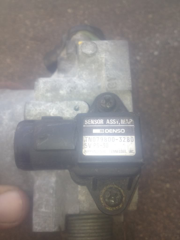

It's not OBD0, the MAP is on top of it. It's also not 96up because it has holes for the FITV. Is there any labels or number markings on it?

all you gotta do is get the entire map sensor part number and plug it into any honda oem website

No labels. 19 and 3 are stamped inside hexagons on the bottom. Besides the IPT stamp there's a stamp on the side that is either GY or GV. The sensor is marked TN079800-3280. I don't think it's specific to this throttle body. When I google it multiple cars come up.
