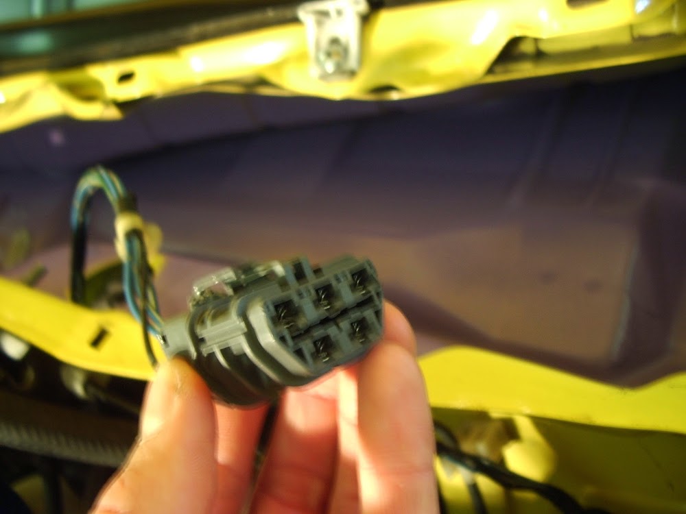

hi i try to tucked engine bay a lil to make things cleaner as possible, but then i stuck on this motor wiper connector i tried to disassemble the 5 pins in the plug but i don't know how pins are plugged in, so if anyone know or have already done this please help i will appreciate it.
this is how pins looked like from the open-ed side

MM&Y of car would help.
It looks like pin "retainer" lock is the "tab" just to the right of your thumb, [red arrow] press in and fold retainer up and out of the way.
Attachment 366577
well i checked that thing at the (red arrow) but there's no "tab" the plastic there is solid molded, no triggers, tabs, anything.

here i'm with the report:
finally! i disassemble one of that motherfu*king pins out, gooh what a relief..
(car is civic EK 99")
that's how it was: i have found the tiniest flat screwdriver in the house that i could possibly found, and then it goes out. the terminal design is pretty much similar to this one
and the connector is G example on the page 7.
BIG thanks to you guys for your support!
