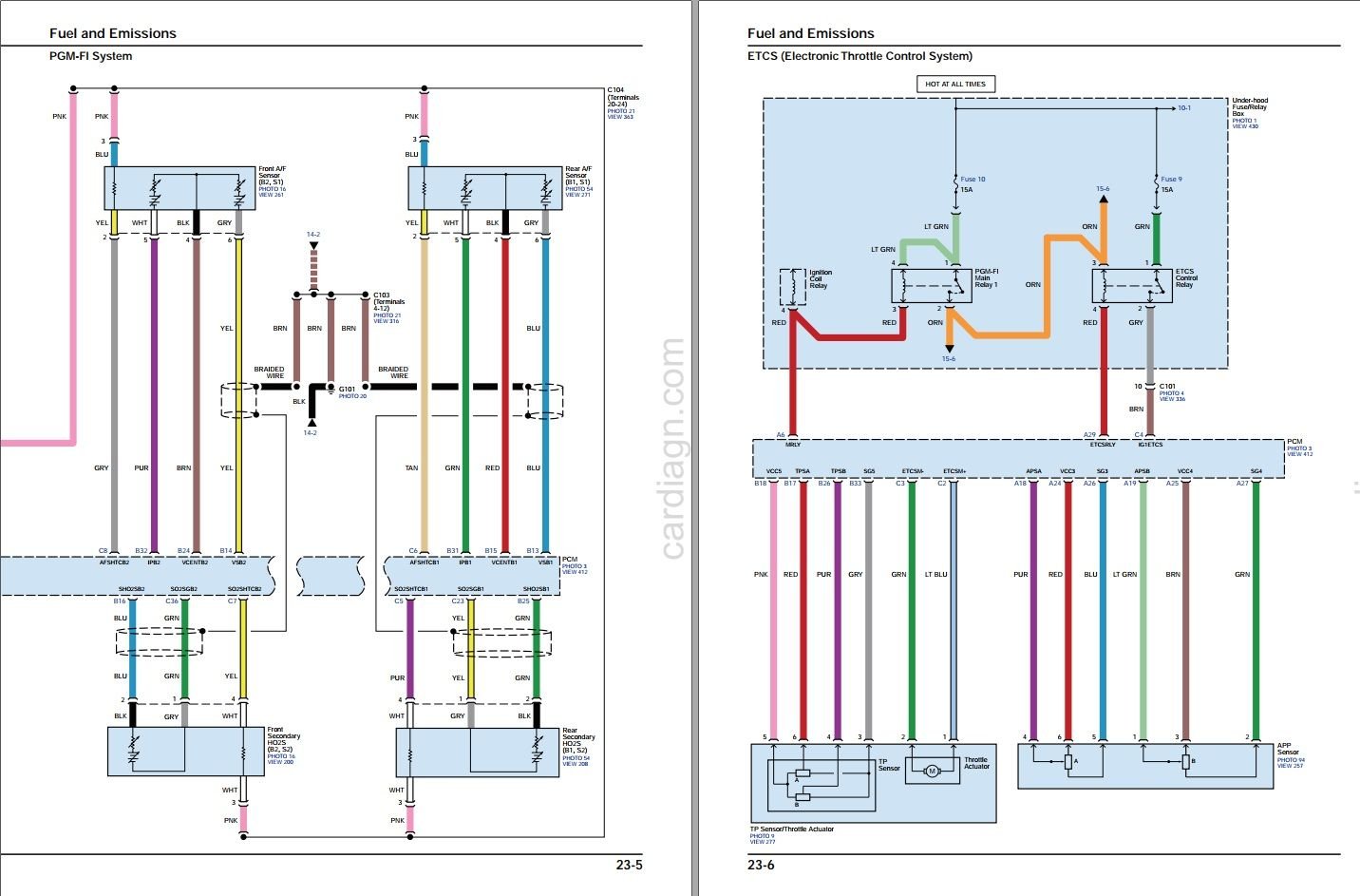

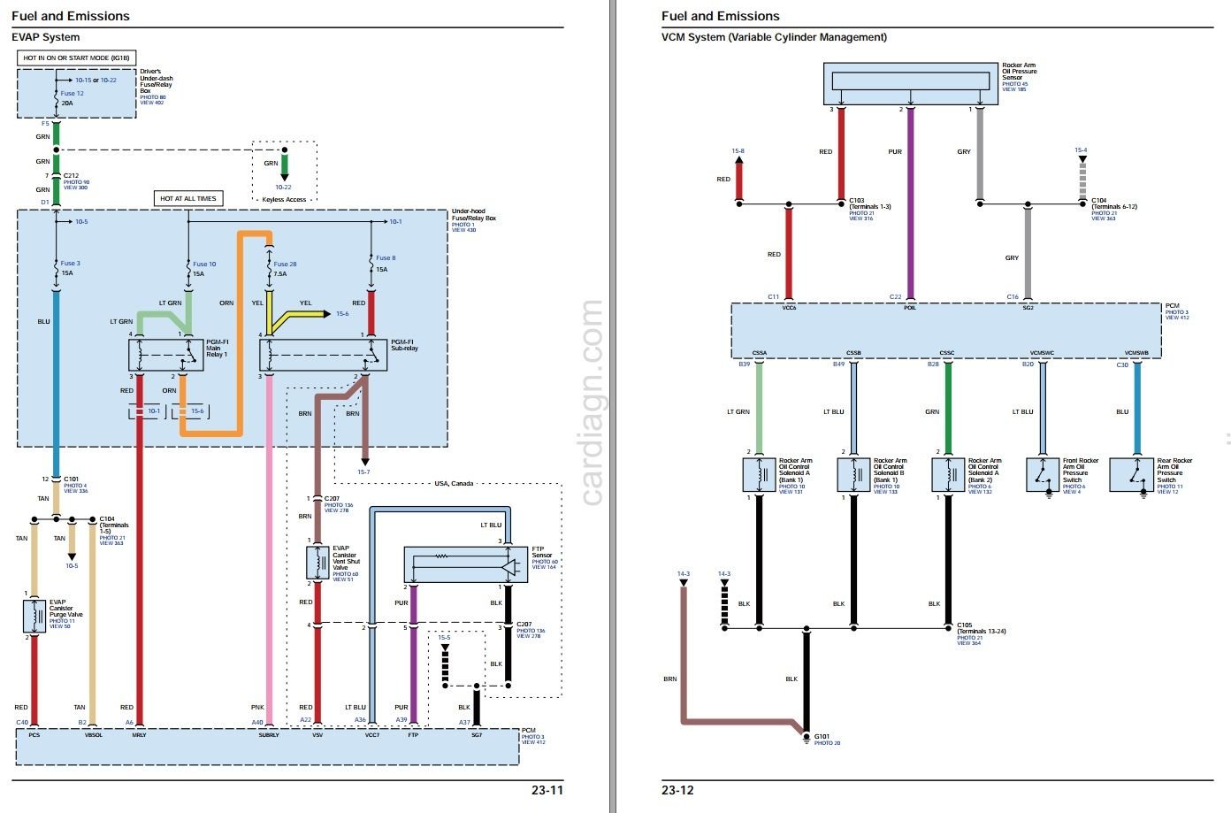

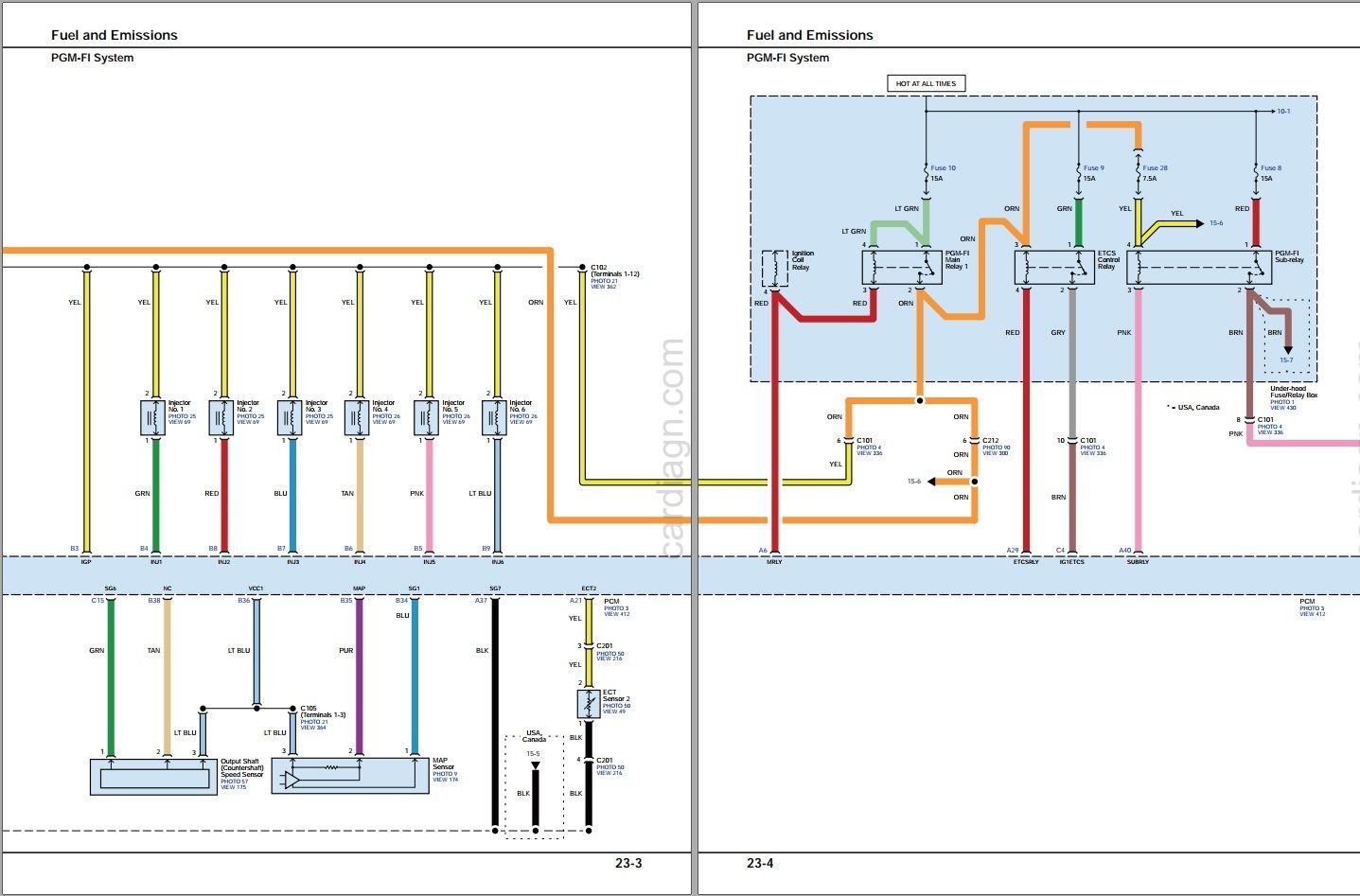

well, looking at the the wiring diagrams, it does like pulling the main FI relay will in fact interrupt one of the conductors going to the injectors, but the way that it's all daisy chained to the sub relay and other circuits, it doesn't give me an unambiguous indication that the injectors won't be able to power through that orange wire that seems to be going everywhere. am I reading this right?
also, has anyone actually done this who can confirm for me that the ecu isn't going to need reprogramming after the test is done because it thinks the injectors are miscalibrated or something?

If the wiring diagram leaves you thinking that you may still get fuel injector pulses when attempting to crank the engine over... simply unplug each fuel injector clip on the engine harness from all four fuel injectors themselves. You may get a "fuel injector" code when using this method, but this can easily be rectified by clearing the codes when you are finished testing.
