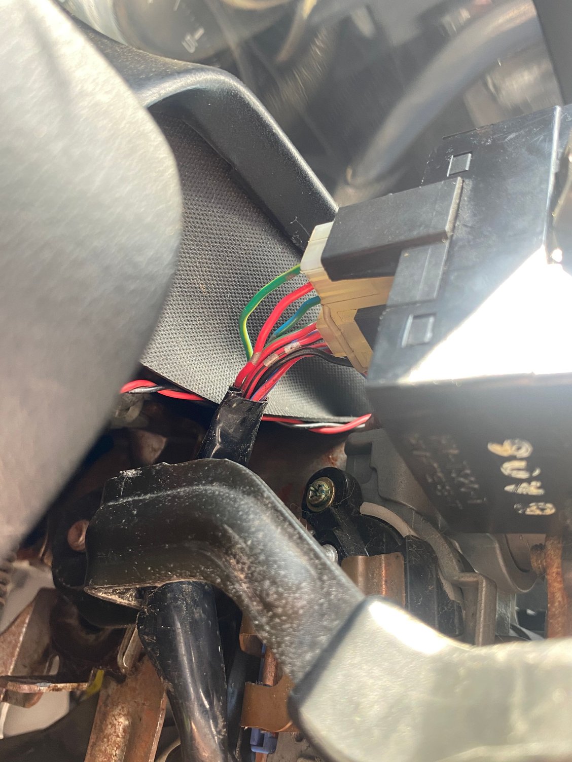

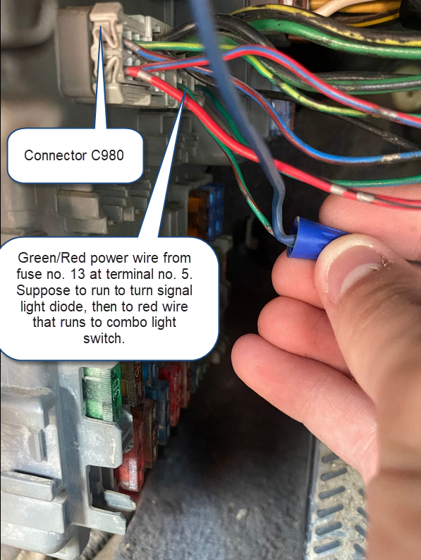

98 prelude, turn signals don’t work hazards do, i traced some wires and got to this would this cause my problem? where do these wires go? thanks
looks like the red wire from the switch is spliced into the green/red for some reason, the previous owner did some questionable wiring

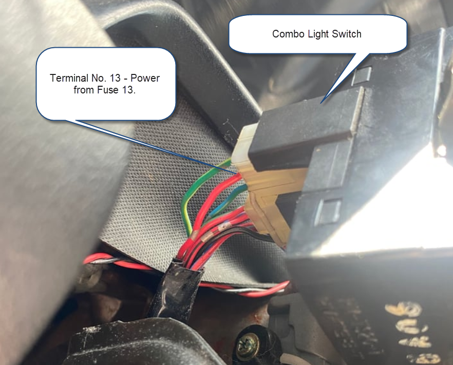

The green/red wire from the fuse box is power from Fuse no. 13. It suppose to run through a diode, which then runs to that red wire that feeds the combo switch for the turn signals.

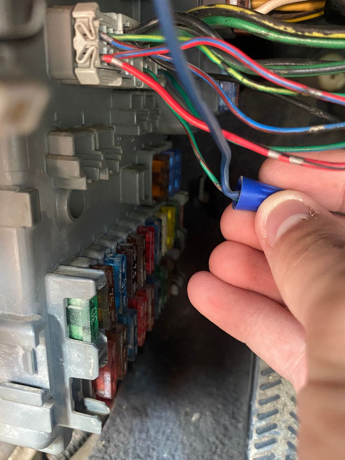

Remove those blue wire nuts and properly solder and cover the connection. Blue wire nuts don’t belong in a car. That’s some hack job

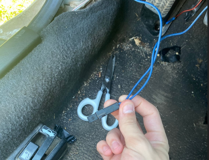

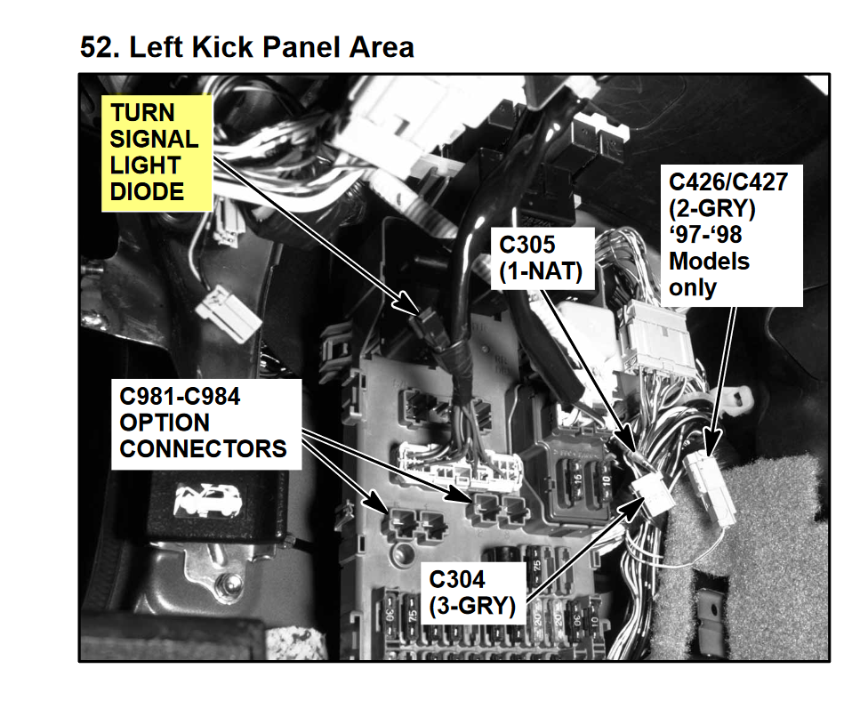

great information man thanks, i can’t seem to find the diode where is it located? there is this thing in the middle of the spliced wires

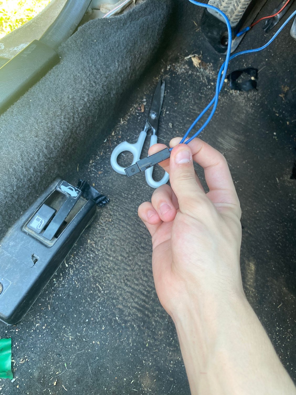

The diode is shown in this photo.

Looks like the previous owner's splice was to connect to a diode.

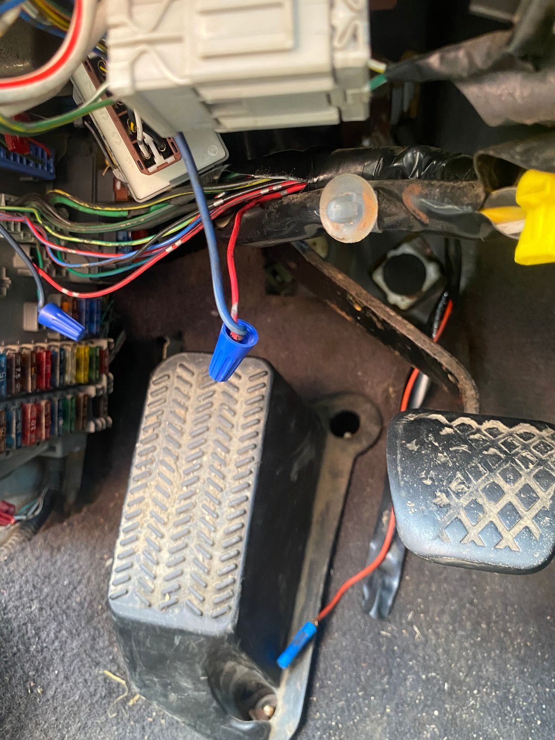

good info👍, fixed the wire nuts and put on some butt connectors and now it works. thanks

say what you want but i’ve never had a single issue with butt connectors, better than those t taps or wire nuts

With a proper crimping tool... I agree.
