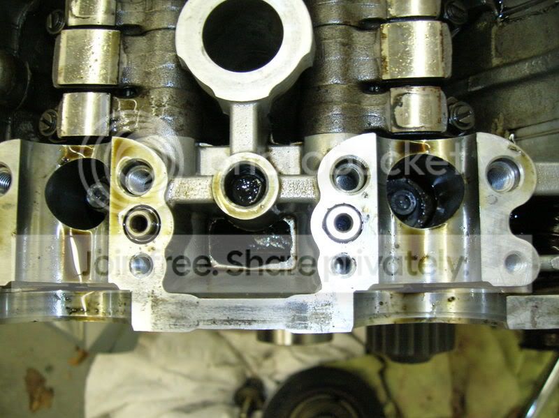

this might be the worst moment of my life. i rebuilt my bottom end because there was a loss of compression and i thought it was the piston rings. i spent a ton of money rebuilding the bottom end, hoping that would fix the problem.
anyways i was putting the head back on tonight and i noticed this, can't believe i noticed it before:
on both ends of the head, there seems to be holes between where the cams would go. this isn't normal is it? what would cause that if it isn't normal? would those holes cause a loss of compression/running poorly?
to further clarify: here's where the holes are:
please help, does anyone know if those holes are supposed to be there or not? and was this why my B16 was running crappy?

that looks like the normal casting of the head.
did you have the head checked/machined/valve job/valve seals?
im sure its fine.

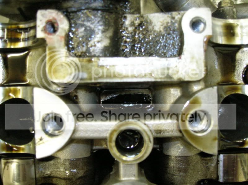

i haven't had the head checked out yet. i'm pretty sure i need to resurface it because there's some small scratches on the underside of the head.
i was just scared because that second picture especially doesn't look like there's supposed to be a hole there - it looks pretty ragged. you'd think if that was on purpose, it be a more perfect oval or something. but if that's how it's supposed to be, that's a huge relief

im 99.99999% sure those are casting impefections........the head is fine man!

I'll second the 99.999999999% sure those are casting imperfections because my head looks just like that!

LOL i thought there was something wrong with my head when i saw the same thing like 2 years ago. But then i saw my friends head and it looked exactly the same.
