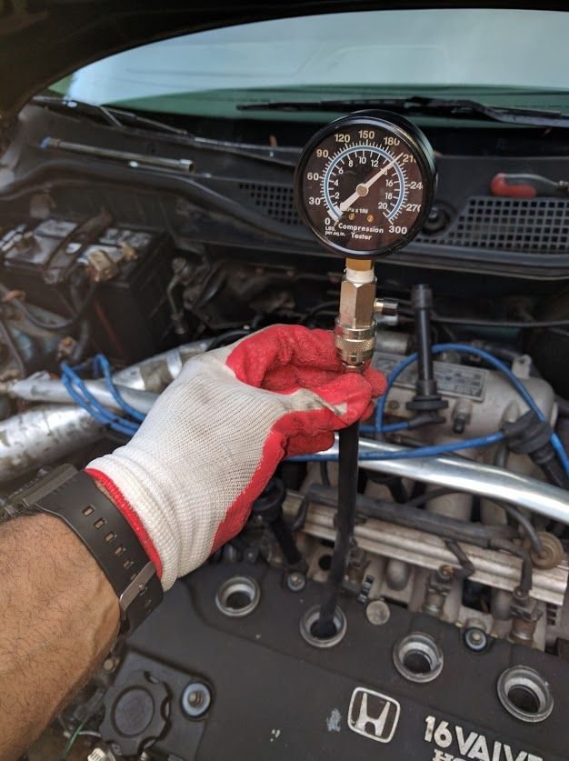

COMPRESSION TEST:
190-200 PSI across the board: )
This was done with the engine cold since everything was unhooked.

It would show up in the compression test and your compression test says it's sealing fine. It appears weird to be seeing bubbles coming up like that but I suppose it could be pulling in air bubbles from somewhere, maybe even the water pump. I would say just pull the water pump and see what it looks like.
It's still possible you have a hairline crack in the block somewhere.
