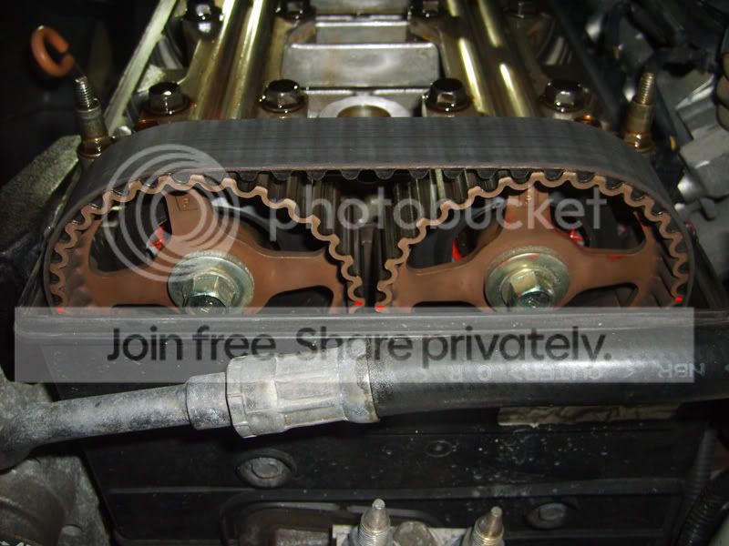

Default Does this look right?? 98 ITR (camshaft TDC)
someone just tell me if these look right? I set it to TDC and moved the distributer back to the middle because it was all the way advanced inorder to just get 18 deg, tomar ill redo the timing. Does it look like everything lines up, the tdc line is just alittle infront of the line like a 1/4 of an inch. O btw the car starts and runs normal just feels mighty sluggish especially in lower rpms compared to before i f'd with the timing so i dont think it jumped a tooth but idk how to check?

Check your camshaft timing to make sure you didn't skip a tooth, if that's ok, set the damn ignition timing back to stock. I don't care if everybody bumps their timing up, you could be getting detonation by increasing it those 2 degrees because EVERY ENGINE IS A LITTLE DIFFERENT. Don't try to tune if you don't know how to. Learn how to drive. You're car is 10 years old, sh*ts not factory fresh. If you want a 1/4 mile car, buy something else.
Is there anything I'm missing?

how do i check the camshaft timing and what am i looking for?
Old Aug 22, 2008 | 03:30 PM
KooK's Avatar
Mustang Sally
Joined: Jan 2002
Posts: 6,092
From: Midwest
Default Re: (importknight)
http://www.team-integra.net/se...=1049

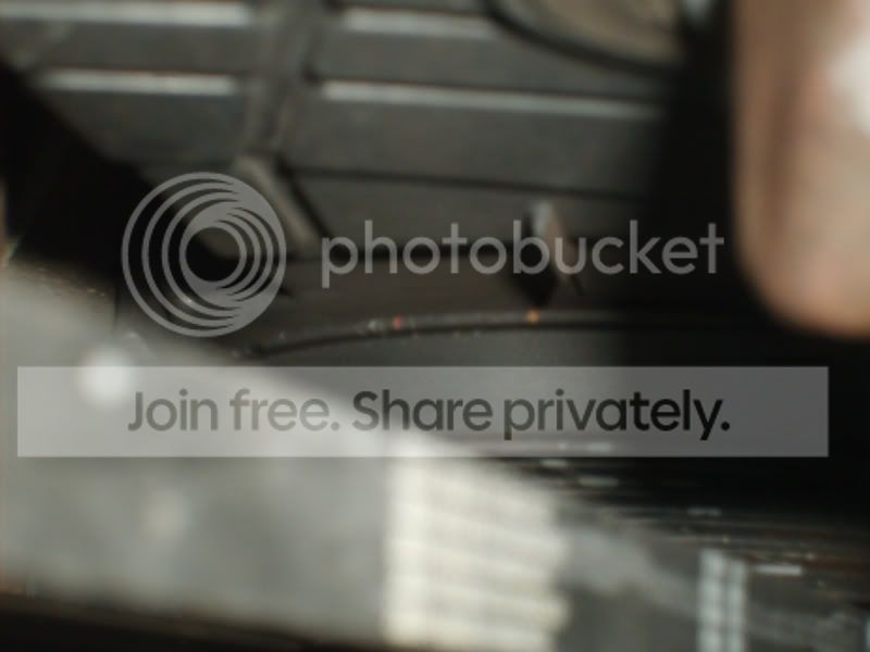

alright does this look right it seems that when all the cam markings line up the bottom mark is less then a 1/4 of an in infront of the line. now if i move the distributer back to the middle and get my timing gun and then set the timing after the cars put back together should everything be ok?

the timing marks on the engine are very accurate, they should line up perfectly when it's all correct. try try and then try again.

I just don't like basing things off of the crankshaft pulley, I like to see look at the actual crank. It's not too big of a deal to remove the p/s and a/c belts to remove the pulley itself, but that pulley can be a pain to get off some days.
