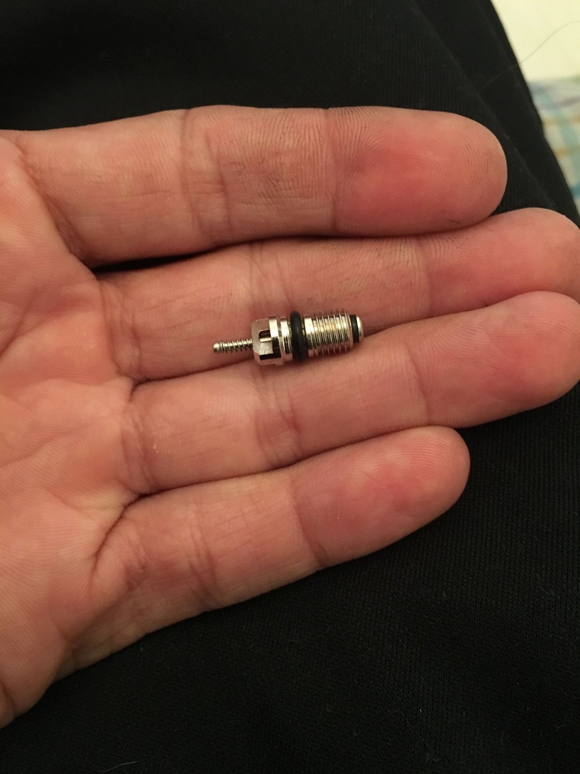

Today I had the lines cleaned out, tested and it read 30psi on the low end and in between 150 and 200 on the high end then I waited. It didn't move, I had also noticed this was slightly leaking, I had it replaced with a new one. It did not leak from it this time around
