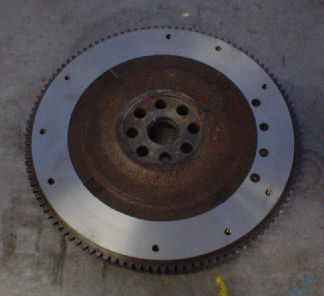

I have an act prolite, I was just wondering about it for a junkyard build.
I saw this at http://www.homemadeturbo.com.
<TABLE WIDTH="90%" CELLSPACING=0 CELLPADDING=0 ALIGN=CENTER><TR><TD>Quote, originally posted by homemadeturbo.com &raquo;</TD></TR><TR><TD CLASS="quote">B16a Flywheel, I took it to get resurfaced at a local machine shop, and asked if they could shave the backside to scrape a few pounds off, he quoted me 75 bucks! I said **** that, so me and Mike G took it to my work and did it ourselves on the Brake Lathe Machine, we got 4lbs off From 18 to 14lbs. Not to bad for 1hr of labor. </TD></TR></TABLE>
