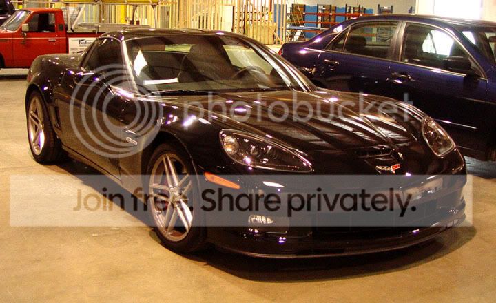

just get a z06 and call it a day
Old Sep 20, 2007 | 06:26 AM
Gearspeed-Performance's Avatar
Posts: 5,903
From: Rancho Cucamonga, CA
Default Re: (Bense)
<TABLE WIDTH="90%" CELLSPACING=0 CELLPADDING=0 ALIGN=CENTER><TR><TD>Quote, originally posted by Bense &raquo;</TD></TR><TR><TD CLASS="quote">just get a z06 and call it a day </TD></TR></TABLE>
The owner just got a brand new one...its one badass car!!!
