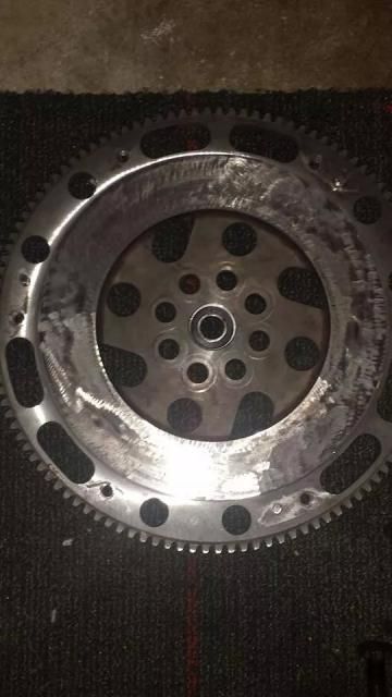

I went to pick up a flywheel today and it looks like this..
Guy said his friend scuffed up so it grabs better? Anyway, will a resurface fix this?

You wont know for sure until you start grinding it. You should be able to make it usable, but there might be some spots that have been ground too deep to fix. Just depends on how good his friend was with a grinder... lol

It can be resurfaced. milled at a machine shop, we have a place here in my town that turns them for around 50 bux, do some calling around ,like big truck repair shops or shops that rebuild clutch disc"s, DO NOT install it like that or you will be doing it all over again.

A resurface will fix that, you may need a spacer behind the flywheel to allow the starter to hit the ring gear correctly, that is standard fare.
A coarse sanding sponge with a bit of time can help bring the surface back without machining. Start with 220 or so and go up to 800.
I cant really tell how deep the gouges are, but if they are minor in depth, the mentioned trick should work.
