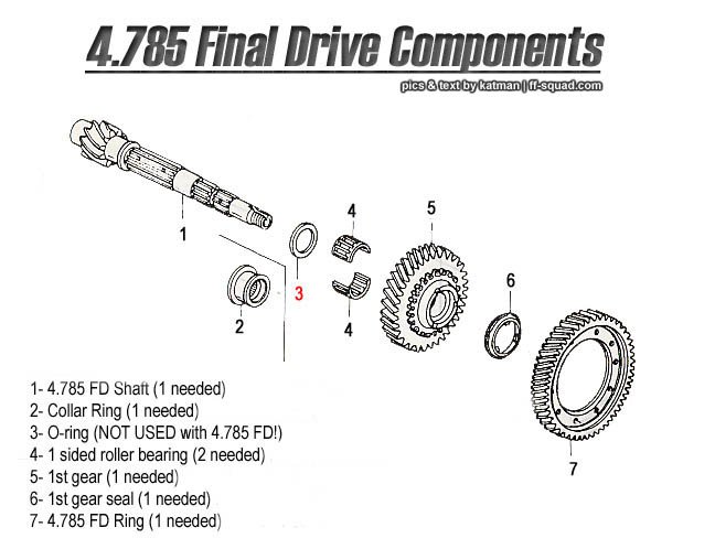

yeah that is right....the 05 RSX has the JDM K20-R cams and 4.7 final drive now, and different ecu pinout locations.
I personally have a K20R engine now which has the 4.7fd by default, but before I went K20R, I did have a 4.7fd in my tranny. I actually had a CTR tranny with a GSR 2nd & 5th gear + 4.7fd. The 4.7fd is really good at the track and I highly suggest upgrading to one along with an LSD.
If you run a 15" wheel or smaller, it actually calculates out to being close to a 5.0fd because of the wheel diameter & gearing technicalities.
Make sure you get the complete kit w/bearings etc, when buying a 4.7, not just the ring & pinion gears; actually its probably best if you buy one brand new rather than used because of the bearings you need with it.
here's a pic of what the 4.7 kit consists of:

right on.. I have noticed that people just sell the two pieces as opposed to the whole set. Why is that? Do some cars only need the ring and pinion gear?
also.. why the gsr 2nd & 5th? did it help? worth the trouble? should i just do the final gear?
If the final gear is just one gear(1st?) how does it affect all the other gears.. basically.. why does it make all the other gears shorter too?
I know this is a lot of questions... but thanks, i'm such a newb when it comes to this stuff.

<TABLE WIDTH="90%" CELLSPACING=0 CELLPADDING=0 ALIGN=CENTER><TR><TD>Quote, originally posted by jwyoung &raquo;</TD></TR><TR><TD CLASS="quote">right on.. I have noticed that people just sell the two pieces as opposed to the whole set. Why is that? Do some cars only need the ring and pinion gear?
well, depending on what brand of final drive you buy, some of the kits are drop in kits, and will work with your existing tranny, but when it comes to the OEM 4.7fd you need the components shown in my diagram if using the FD in any hydro US B-series tranny, because the bearings & etc. are different than the 4.7fd parts.
This was of personal preference, but I used the GSR 2nd because its a little bit of a longer ratio than a type-R/B16A 2nd gear which is almost useless with the 4.7 because of its short ratio. I actually had 2 tranny's total in the past that I used a 4.7fd on, first one had type-R 1-4th gears & GSR 5th. GSR 5th was used for better gas mileage on the freeway. 2nd tranny was a CTR tranny w/GSR 2nd & 5th.
The FD is NOT the 1st gear. Its the gear that 1-5th filter/mesh through and output power to the axles. Think of a 10speed bike - you have the gears on the back wheel and the crank+pedals in the center of the bike which acts like a final drive. Its a math equation, 1-5th gears have their specified ratio and so does the final drive, usually the higher the ratio number is the shorter the gearing will be for both the gears & fd.

when you said ring gear, in your picture you meant the #7 item right? just verifying. I'm looking on ebay and I'm looking at the LSDs that are for sale and I dont' see a single 14 hole LSD. i even googled "ctr lsd"
http://cgi.ebay.com/ebaymotors...33731
check it out.. he says it's from the CTR but i still count 10 holes. I'm so confused

<TABLE WIDTH="90%" CELLSPACING=0 CELLPADDING=0 ALIGN=CENTER><TR><TD>Quote, originally posted by jwyoung &raquo;</TD></TR><TR><TD CLASS="quote">when you said ring gear, in your picture you meant the #7 item right?
correct
keep looking; do a search on H-T's classified section
I see 10 holes, the screws are in the holes though.

i think i've come up with the answer...
the RING gear that comes with the final drive set.. is what you have to make sure you get b/c it has 10 bolts. i guess on the civic, it comes with a 14 bolt one that doesn't work and you have to replace when getting the final drive. sound right?

<TABLE WIDTH="90%" CELLSPACING=0 CELLPADDING=0 ALIGN=CENTER><TR><TD>Quote, originally posted by jwyoung &raquo;</TD></TR><TR><TD CLASS="quote">i think i've come up with the answer...
the RING gear that comes with the final drive set.. is what you have to make sure you get b/c it has 10 bolts. i guess on the civic, it comes with a 14 bolt one that doesn't work and you have to replace when getting the final drive. sound right?</TD></TR></TABLE>
Well yeah you NEED the 4.7 ring gear anyways cuz its part of the 4.7 kit. You need the whole 4.7kit because none of the hydro final drive parts (accept a GSR diff) are compatible with the 4.7 kit, it uses its own special parts (shaft, ring, 1st gear, bearings/collar bearing etc). In fact, you're gonna need a GSR diff or ITR LSD when you upgrade to a 4.7fd because the ring gear is 10bolts and will only accept a GSR diff or ITR LSD, all other hydro b-series trannies use smaller diameter 14bolt diffs/LSD's.

I'm looking to buy an LSD from a H-t member and he says it comes with speedo gear and bearings.. is this the same thing we were talking about here?</TD></TR></TABLE>
Uhh..the speedo is its own unit, not sure about the bearing side of it, but I dont think its the same bearings used with the 4.7 kit. Maybe ask him for a picture of the speedo & bearings. He could just be talking about bearings for the LSD.
What kind of LSD is this HT member selling? ITR?

the lsd i'm buying is from ITR.
are there any limitations to LSD? i mean if i'm not putting down that much power.. under 220whp, then is there a real need to go with quaiffe or something of the higher end?
now i need to find the FD and clutch

<TABLE WIDTH="90%" CELLSPACING=0 CELLPADDING=0 ALIGN=CENTER><TR><TD>Quote, originally posted by jwyoung &raquo;</TD></TR><TR><TD CLASS="quote">the lsd i'm buying is from ITR.
bitchin
I guess it depends on how you race your car, or if you even race your car at all, and the type of racing you do. If your car is just a daily driver & weekend racer, ITR LSD is just fine, no need to waste $$ on a higher end/crazy-aggressive LSD. THe horsepower factor doesn't really matter, usually most OEM & good aftermarket LSD's can handle a high amount of horsey power. The gear type LSD's are the best vs. the clutch type (clutch type has internal clutches that wear out over time). ITR LSD's are a gear type LSD btw.
