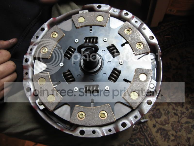

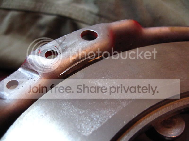

figured id post my experience even tho im bringing this back from the dead. so just incase someone else has this problem it might be the clutch disc is too big for the pressure plate and not allowing it to back off the flywheel. My clutch was a clutch specialties 6 puck sprung. look at the pictures. the disc actually made marks where it hit the pressure plate.
so basically when it was bolted down the pressure plate was actually keeping the disc on the flywheel...i sent it back and they sent me a new one and it works great..
