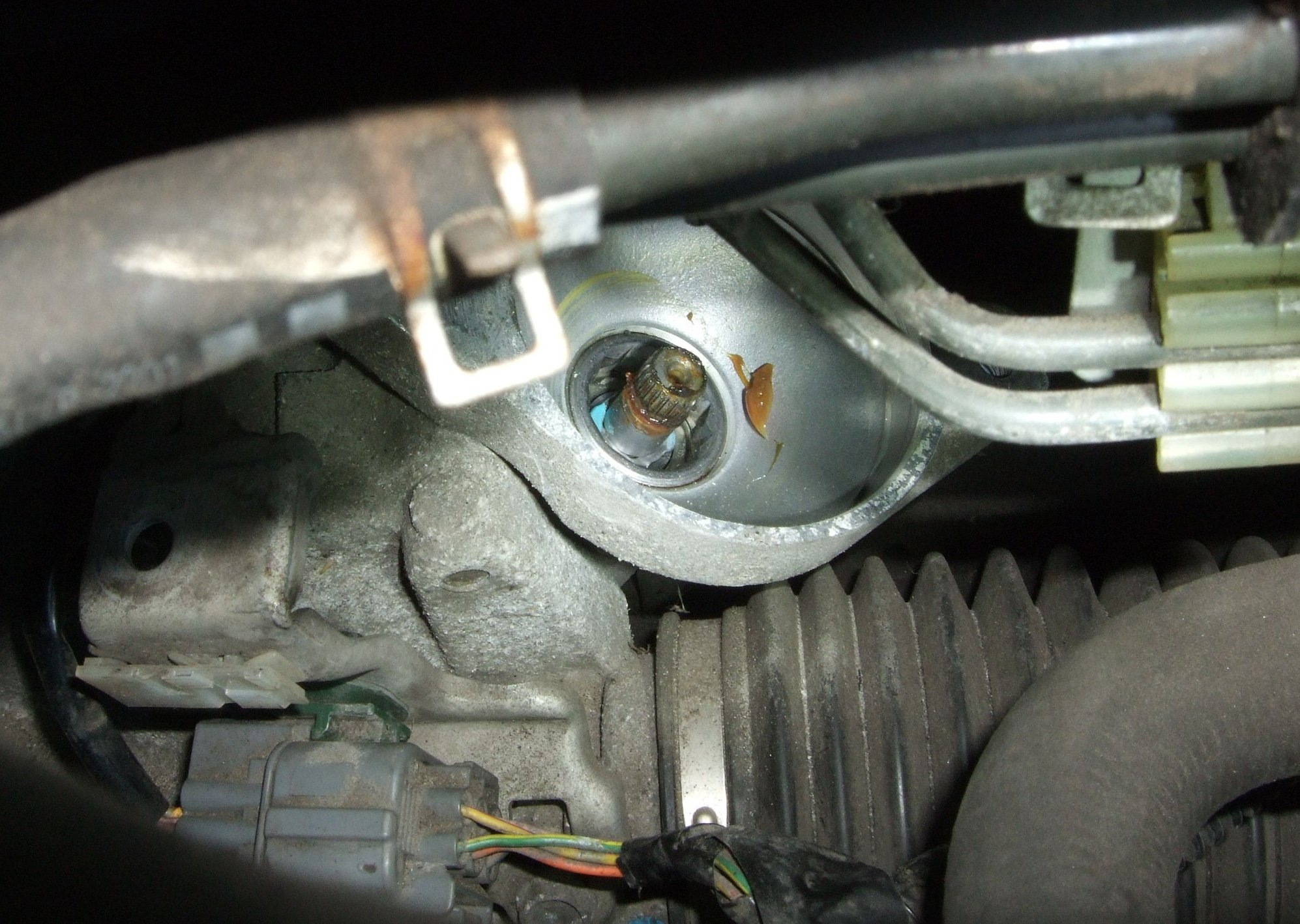

I have a 2002 Insight and I want to get rid of power steering. Unlike CRX for example I cant install a non PS rack and Im wondering since the rack is electric, can I just gut the electric drive parts and be on my way since you cant really do that with hydraulic racks.

Hi, Did you proceed with this delete? I've bought a 1.6 petrol auto gen7 Civic with EPS lockouts after the car warms up but the motor and all other parts remain cool. It has a wrong ECU part number and I cannot locate a correct module. I'm thinking the manual steering would free up somewhat if I simply remove the motor. Would anyone have any thoughts on this please? I'm fairly spanner capable and in the UK if that matters.
The 2002 car looks like a 2 years old car underneath and at only 85K miles the very clean otherwise reliable car is much too good to scrap.
Edit: the EPS resumes after an immediate restart but soon knocks itself out again. EPS fault code is 41: motor voltage.

You could probably toss a new controller at it and fix the issue.
But if you must I do know the answer to this.
Remove the motor, under the motor is a worm gear. Remove the nut holding the worm gear in place and then reinstall the motor to keep dirt out.
This will remove the friction of back driving a worm gear.
I have some pictures I can dig up. I also posted about this over on insight central . Net under the same username.

The project is under way, I'm waiting for a 50mm (2") length of 20mm brass hex rod to arrive from ebay. The delete can be done in situ with a bit of grunting. This is one time I wish I had smaller hands but I had an offset 1/4" drive ratchet that was a great help. The motor is off but that's as far as I can go till I get the brass and bore it out. It still feels too stiff to let the wife use it but I'm hoping it will ease off after I get the worm drive out.
A slight tangent:
While I'm waiting I decided to inspect the motor - suspecting the casing could be bunged up with carbon dust because its not vented like a vacuum cleaner or power tool for examples. I think it was meant to be tamper discouraging because neither a T20 not T25 anti tamper hex tool would readily fit - maybe there is a rarer T22 with a larger hole available but i managed to enlarge the T25 anti tamper peg hole and tap it in using an extension and hammer. Carbon dust dropped out as I pulled it apart against the magnetic force and a good brushout and compressed air blow saw more but i doubt it was enough to be a cause of the issue. There was stacks of travel left for the the four large section carbon brushes.

So... cleaning out the carbon dust from between the copper commutator bars and between the brushes has completely sorted the issue -
despite the EPS ECU being a wrong part number.
Wife with her arthritic hands is very happy with it.
