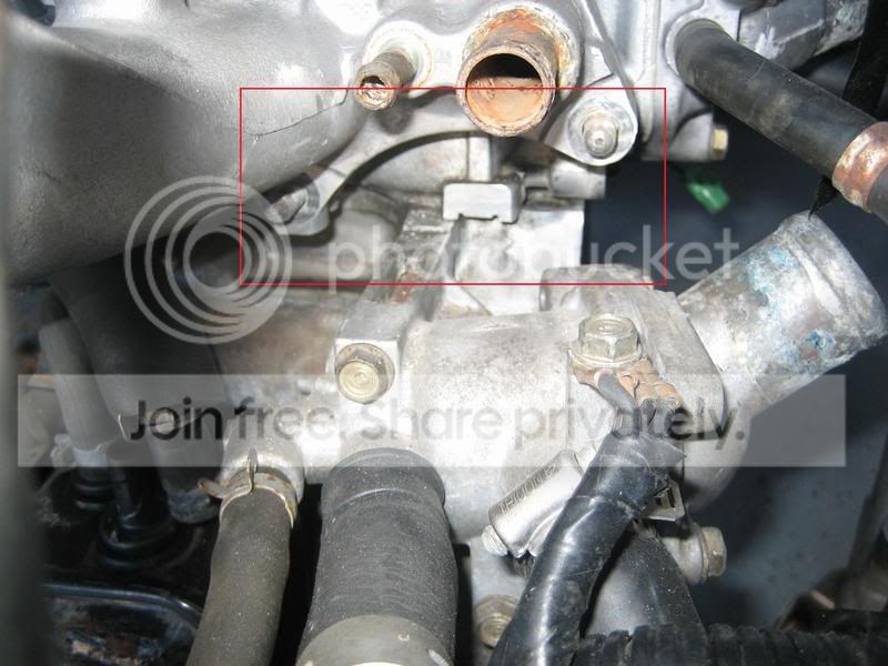

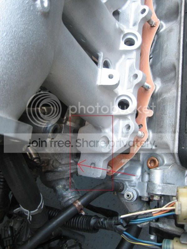

I purchased Victor X for my B16A now I’m trying to install it. I was under the assumption its a direct fit. For those who have installed it did you have to cut part of the flange
Edelbrock
OEM (PR3)
Modified by GarretCRX at 3:19 PM 10/10/2008
Modified by GarretCRX at 4:39 PM 10/10/2008

i would just cut it off, the problem is most likely the difference in block heights between b16 and other blocks

I wouldn't cut anything off, Should seal just fine. If your still in doubt give Edel. a call. just my .02

i was under the impression that it was hitting something, if is not yeah dont worry about it like said above . its nothing

its hitting the coolent hose the bolts wont line up. if you look at the 1st pix you can see where it hits i put an arrow
