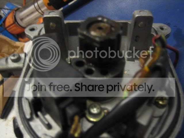

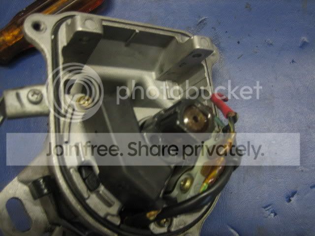

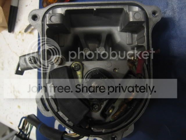

Are there any ways out there to take this metal piece of the rotor off of the shaft. I completly broke off all the plastic parts of the rotor doing the replacement and can't get this piece off. Theres rust around it and I have let it soaked in PB blaster for awhile and still cant pull it off. TIA
Here are some pics to help visually:

Did you happen to remove the retaining screw in the side?

haha yes i have, that was a bitch to take out too!

Just checking...keep prying i has to come off eventually, tap the rotr with a rubber mallot lightly then turn and pry tap turn and pry...repeat if necessary. Good luck

You can try heating it up with a lighter or a small propane torch, its your best friend for things that are a very tight fit, like broken distributor rotors or transmission bearings.

Impact screw driver on the set screw.. make sure to support the shaft so that you don't damage it

maybe heating it up might work. as for the impact screwdriver, its not the screw im having trouble with (already dealt with) its the metal piece that goes on the shaft.

thanks to all that replied, got it off
