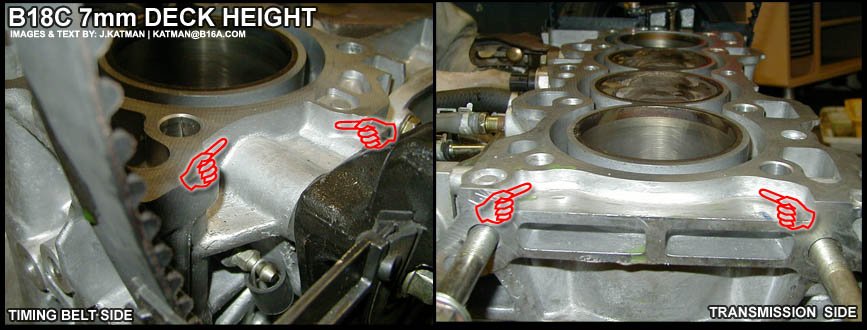

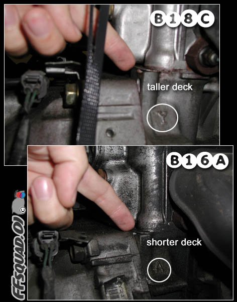

Here's an example of the difference in deckheight between a b18 and a b16 block, notice how the b18 is taller:
Here's another shot of the b18c 7mm deck
Pictures courtesy of Katman.
