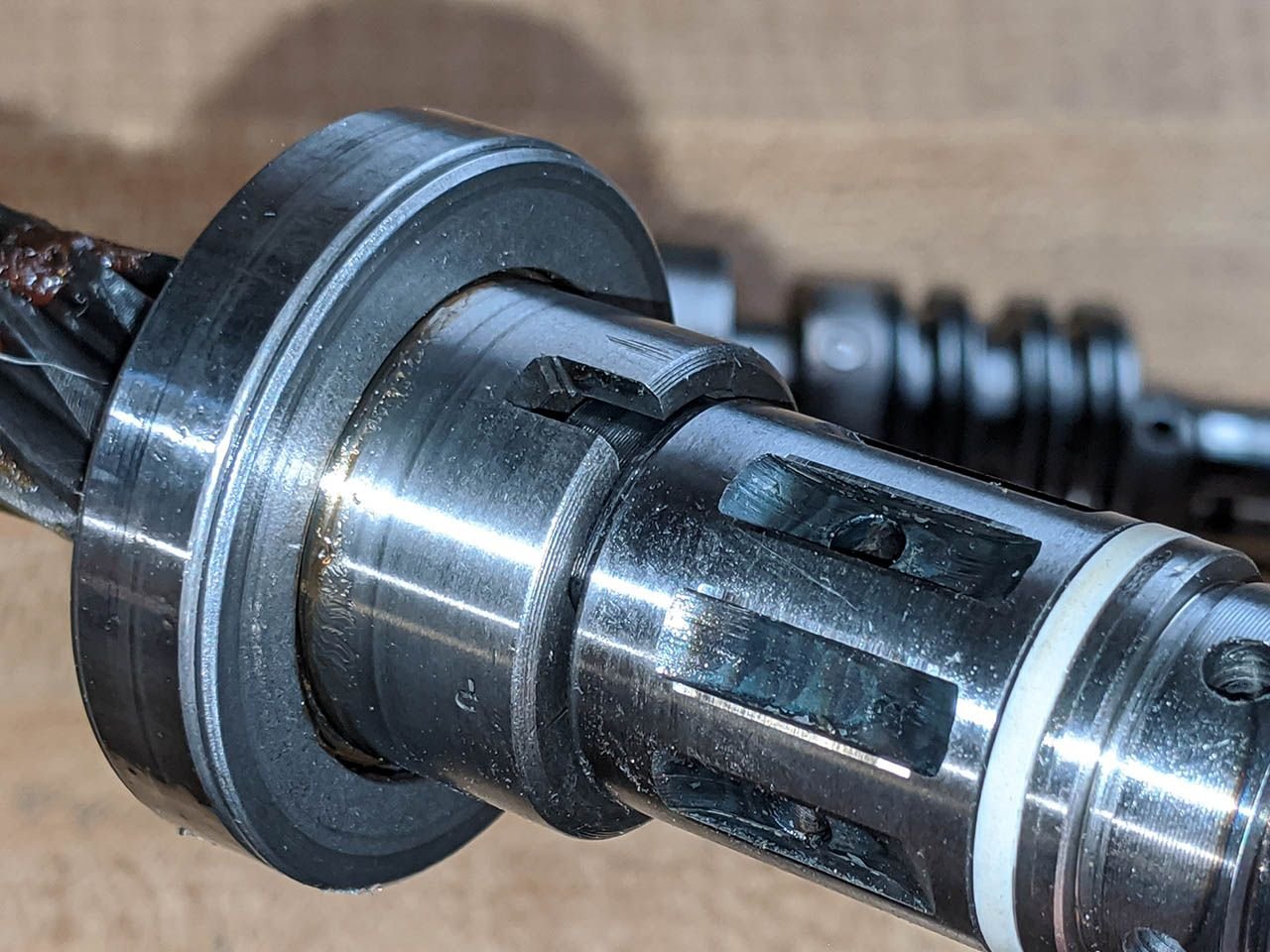

In this pic I ground away where the input section meets the pinion section. You can see the space between the two. It can only move a few degrees before it hits the internal stops.
The input splines have a pin that goes thru the top of the torsion shaft. FYI: a heavier torsion bar reduces assist and gives power steering a 'heavier' feel.

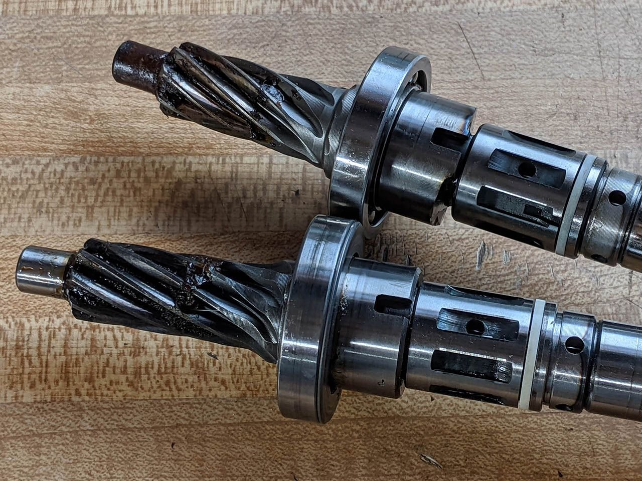

Integra 9-tooth pinion bottom vs EK 8-tooth pinion above. They are interchangeable, so you can increase an EK's steering OR reduce an Integra's steering by swapping. You might have to re-shim tho.

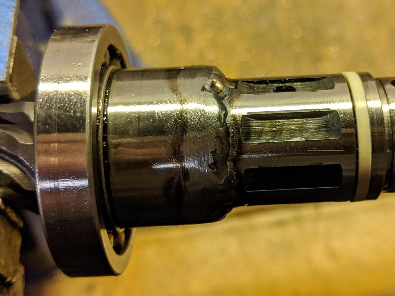

The final result after welding. It doesn't need much, no more than that pin at the top would hold. Even if the weld breaks, it will still have the internal stops. I recommend you only weld 3/8" sections at a time to keep the heat low and switch to opposite sides to keep the shaft straight. I wrapped the bearing and gear in tin foil to keep weld spatter and grit out of them. The bearing will initially feel gritty if you get it too hot, but not a big deal since this is a low speed bearing. I also put tape on the upper seal section and lower - if you char the tape, it's too hot.
If you look between the weld and bearing, you can see a faint line - that's where the seal touches. Do not weld near that! You also want to smooth it out so you don't damage the seal when installing it. The seal doesn't need to be replaced since it's no longer holding pressure, just separating a fluid-filled section from a grease-filled section.
