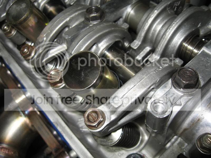

Well i went to adjust my valves today in my new head. Its a y7 with a delta 272 regrind cam. I adjusted cylinder 1 at TDC. I went right inbetween factory specs @ .010'' and this is how far the adjustment screw is. Any idea if this is ok?? What can be wrong? Anyone else running a delta cam with this type of problem? Can i run it like this?
