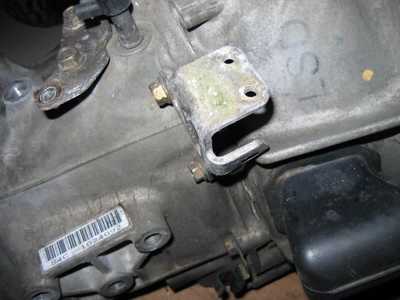

Default What stamp is on this??????? Help!!!
http://img.photobucket.com/alb...s.jpg
This person is selling me a ctr tranny. Stamp says r4 lsd. What is that! Vin is sc41024092 any know how to decode that vin?
Thanks

Default Re: Ctr Tranny Help What stamp is this? (supertran25)
I know j4d is usdm or 96-97 itr.
I know that n3e is jdm 98+ itr
What is this?
http://www.allmotorhonda.com/t...s.htm
its either a 96-97 itr or a ctr. same final drive and gearing

Default Re: Ctr Tranny Help What stamp is this? (4g hatch)
Just found a thread where someone said R4D LSD was stamped on there ctr tranny.

IT GUY's Avatar
Posts: 3,951
From: atlanta, ga, usa
S4C trannys only came attatched to b16's
gearing is the same as the S80's in the ITR
