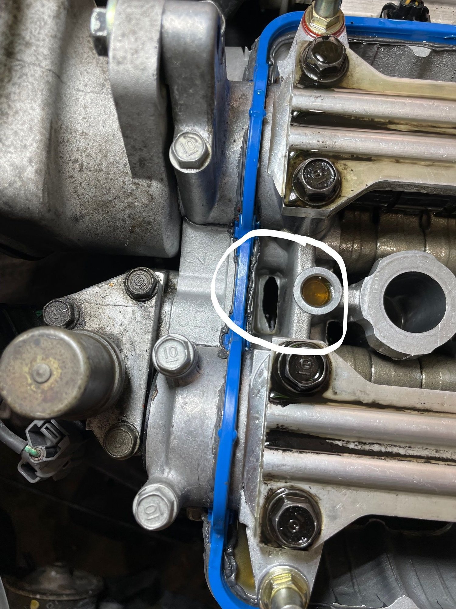

So after wasting my time rebuilding the engine i noticed today that the engine was getting hot and turned it off. I took off the valve cover and noticed this hole in the head. What could have caused this??!!

It is a normal "as cast" drain back passage for oil. It is NOT a cracked head... at least not there anyway.

I wasn't suggesting that you don't have a problem... as in you aren't overheating. I simply stated that the area that you circled in the photo you posted is NOT your problem. So if you are mixing fluids, you have a head gasket, head crack, or a head surface/block surface issue.
