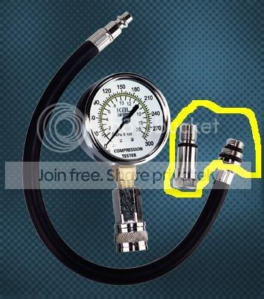

hose broke off but the rest is still in there
see pic for what is still in hole.

Pic of your valued tool:
Next time coat the tester threads in oil or anti-seize before testing.
Also, you don't need to tighten it down much either. The compression will do a good job of that as you can see. HTH

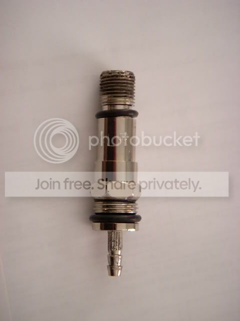

here is a pic of what was stuck down there.
i took off the rocker assembly and with that most of the spark plug tube comes out too. after it was off i could grab the piece with vise grips. it came out really easy.

it was screwed in to the spark plug hole. it wasn't just sitting in there.
a magnet would have pulled it out if it was just sitting in there

I see why the ez out wouldn't work now. wtf is that thing inside of it anyhow?

It looks like something is wrong with the threads at the bottom. Did you do that trying to get it out, or do you think that might have been the source of the problem?

maxpsi, the threads are fine, it's just some anti seize.
snowseaker, it's the part that goes in the hose. when i was trying to get it out the hose fell off.
