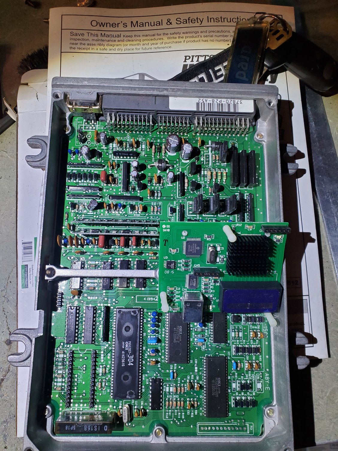

Still busy with the s2k and procrastinating on the civic because it's pouring rain. Anyway I noticed a new symptom, fuel pump takes forever to start priming. I tapped the main relay and it came on but might have been coincidence. Can a bad main relay cause a rich condition or is that not a thing? It's a cheap one-off, the OEM one went bad a long time ago.

Well ****, was going to get parts but the pump won't prime at all. Plugged the stock ECU in and it primed right up. Took the p28 lid off and everything looks fine. Might have to go to work tomorrow with the stock ECU, risking some cylinder wash.
This is actually good news - it means the capacitors have likely failed but not leaked electrolyte onto the board yet, which typically destroys traces and other components around it. Replace the capacitors now before they leak.

Alright, I'm back from the dead! I just re-capped the board, the old ones weren't bursting open but they pulled right out and were crusty. The pump primes right away now!!! But... it won't start. Cranks fast, doesn't seem unhappy but just won't start. Where do I go from here? I'm guessing check for continuity between ecu harness and blue wire on dizzy connector? I think the problem was there with my other dizzy so I doubt it's the TDC sensor itself but who knows.
