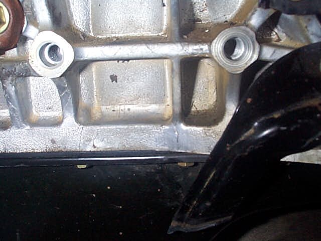

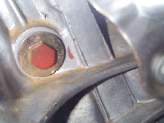

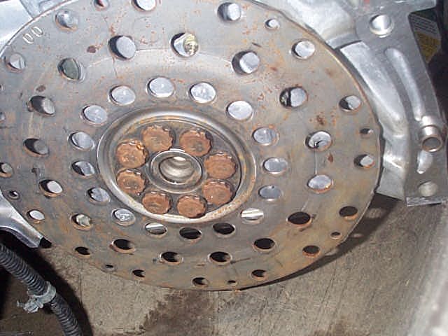

small somthing, dont know.... the bolt looks painted red but its just a little rusted, but does that small crack look serious??

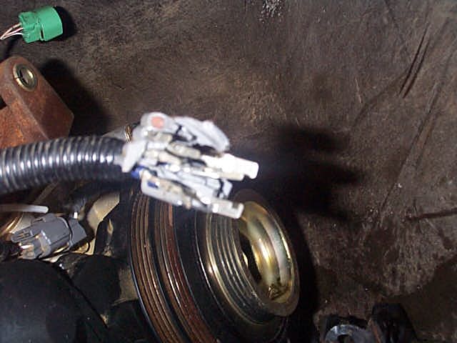

broken plug
bad flywheel? i thinks its automatic?? what to do?

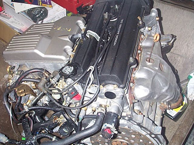

heres the motor
What the **** is this? its down by the oil pan....

yes it is an auto. Just throw a flywheel on there and you're set. The thing by the oil pan is a bracket to help hold the exhaust system up.

well make sure to get the correct bolts for the flywheel... the automatic ones are too short

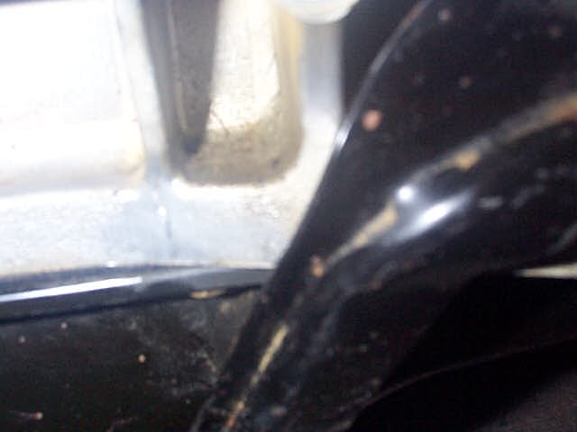

no no, if you look at the bottom, right above the oil pan, there are two tiny cracks, you see them?

looks like flaws in the cast

is that a very bad thing? the block is "cracked" so to say is it????!?!?!?!?!
its just like, small imperfections? or am i screwed

So thats the ugly auto flywheel eh? nice to finally see what it looks like....

Looks like casting "flash"to me. it's no big thing.

its like a small crack though.... im getting it tested soon though.. im just nervous

Wrong, that is the mount for the intermediate shaft.
Thos dont look like cracks, they look like casting irregularities.

this possibly a stupid question, but what the hell is that at the rear where the inlet manifold/throttle body usually is? Is it the air box? I've never seen one like it before!

not a stupid question, its a resonator that is supposed to increase midrange torque,
but im not using the b20 IM, so that thing is gonna go too....
if its going in a civic you cant use the b20 manifold anyway
it will hit the hood.
all b20's are automatics
and the crack is nothing.

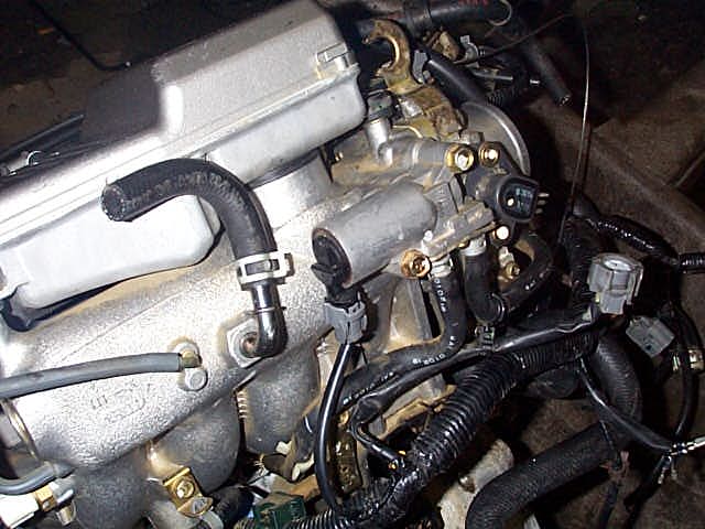

that rusted bolt will be ok. tps needs to be replaced.

i feel much better knowing the cracky thing is noting, thanks for the help

i could be wrong im pretty sure the b20 manifold WILL actaully fit in a civic, ive seen pics... and the silver airbox thing is no higher than the valve cover..... its definetly restrictive though
