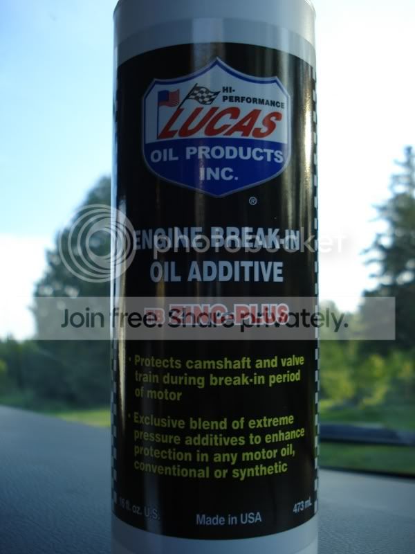

finally there is no zinc in the oil
a second issue arived on another engine I build with the same oil

This brand is new to me...
Lucas Oil representative give it to me

We have to use that additive on all new cams in jep and chrylser products. I always have used a bottles on any engine I build with new cams. It won't hurt anything if you don't need it, but it will screw something up if you don't use use it. We had a jeep come back after 120 miles with flat cam lobes because the tech forgot to put it in.

seen that thread long time ago. i don't think the change in oil additives recently affects Honda's that much. there are millions of Honda's on the road all ranging from stock to aggressive valve train components. if the oil additives had such a big impact on wear we would be seeing ALLOT more issues like this rather than a few isolated cases.
like i said.....i had bad/sticking LMA's on my exhaust side only and the wear on my camshaft was on the VTEC lobe of the exhaust cam only....once i replaced the LMA's, cams and lifters everything was fine......heck i even used the cheapest engine oil from walmart and the cams do not show the same wear like before.
lets face it.....all our old *** b16/b18 heads are starting to show their age. components wear out over time.....time to carefully inspect everything and replace as needed.
