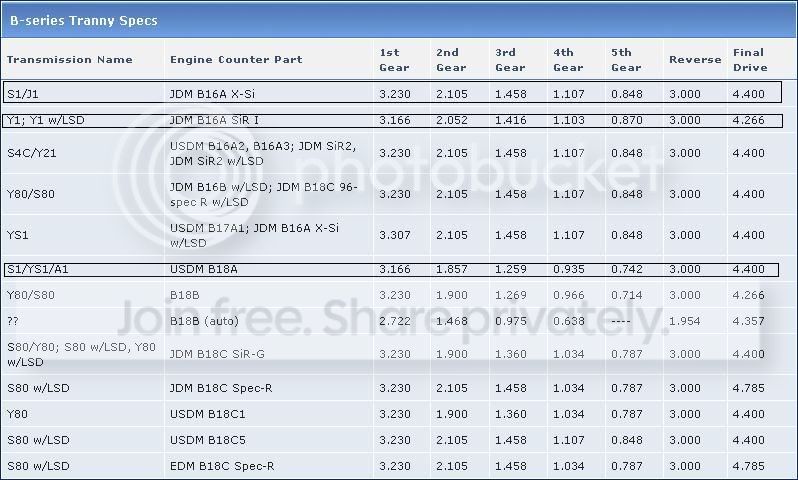

i saw a thread with the gear ratio of this tranny compared to the cable b16 and from what i see it says its shorter im a n00b when it comes to gear ratios any help would be greatly appreciated. o and im going for an all motor setup.

no, its longer, the higher the numbe means its shorter.
BTW the cable a1,s1.,j1 ls trannies have a shorter 3-5th and a 4.4 FD.

o damn i got excited i kinda thought that after a while thanx
