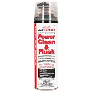

so ended up picking this stuff at autozone, it's compressed and did most of my lines and compressor with it. i will have to buy another can for the condenser/radiator and the inside cab a/c stuff. blew air through the system afterwards. more to come...
also won't most a/c shop do a flush when i take the system in to get charged?

You should not use air to blow out the lines, the flush "propellant" is most likely nitrogen, it is what we use with our bulk flush, air is full of moisture and that is not good for the system. 94

so what's the best way to get the rest of the flush out of the system? all i have access to is a compressor..... also what would be the best way to flush out the EVAP since it's all coiled up. I know the flush would be pretty hard to get out of the line.
This flush i'm using is kind of oilly.

Oily flush is very bad. You will never get it all out. The best flush is liquid refrigerant, but that is pricey and most shops wont bother doing it correctly because it is cost prohibitive to the customer. Admittedly, we dont. So the next best alternative is something like this
http://www.4s.com/Problem%20Solving%...I/Content.aspx
it evaporates fairly quickly and only a minute amount will be left over, unfortunately it is corrosive and can damage seals and the orifice tube(doesnt apply to you obviously) it is not common but it CAN happen, however it is a hundred times better than any "oily" flush you may use.
