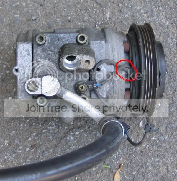

-1998 acura integra 2 door
-b18b1
its the wires that has the red circle.the ones that look like its stuck to the pully!!
anuways anyone know how to put these two wires back in where they are supposed to be?my a/c compressor isnt clicking due to the fact that the wires aernt connected.everything else works fine, but its just these two wires i need to put back.anyone got any sites that show how to do this, or can anyone give me some tips...THANKS

those wires connect to your stator which is inside the pulley. you might have to replace the stator which you can if you have to. just take the pulley off and you should be able to pull the stator out.

wats a stator?got any pics, or any sites that can guide me on this??THANKS

yeah if you pulled those wires out , then you need to replace the ac clutch...if you can find the clutch by itself....If you are unsure of what you are doing then take it to a shop, you have to have an ac clutch puller to get it off, or you will destroy the compressor

A stator is a magnet that pulls the clutch in to activate the compressor when you hit the switch to turn the A/C on. not sure of any sites that would help out but i will look around for you.
