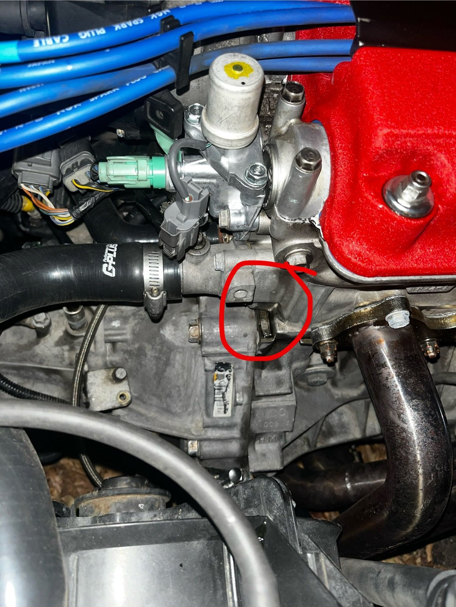

I recently got this car swapped, don’t know a ton about the engine but I have this pesky oil leak that I can’t seem to find the source of. The leak is not major at all, I’m just having trouble finding where it’s coming from and seeing if someone had a similar issue. I have already replaced the cam seal with a skunk 2 billet seal, but that didn’t resolve anything. Any help would be great

The engine leans forward, so from where you have circled, move back toward the firewall and up toward the valve cover until you find the engine dry... the end of the wetness will be your problem area.
If you are having a difficult time assessing this now, spray the entire end of the engine clean/dry with Brake Clean, drive the car around for about an hour, and then re-inspect. You will find it.
